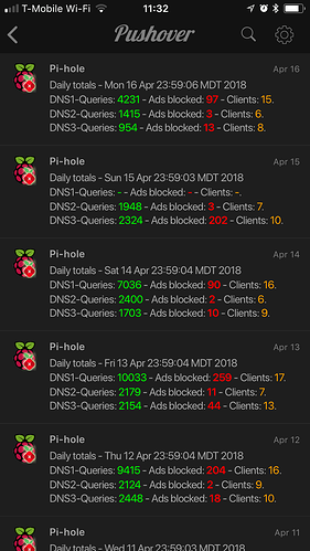

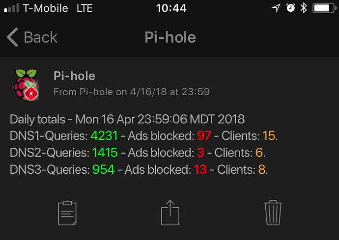

I personally use push notifications to my devices with that info and it looks like this:
