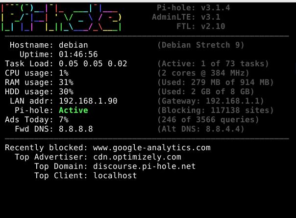

But still I can't access it. I again assigned static IP, changed to iface eth0 inet static . Nothing happens. Now, Iam lost. Please see the screenshot. It's running, but I just can't access. See log at https://www.dropbox.com/s/78qbx98lt2lpbvj/pihole_debug.log.txt?dl=0
How are you accessing the Chronometer output? It appears that your Pi-hole has IPv6 network access, but not IPv4. Why did you try setting an IP before running Pi-hole's install? Pi-hole will set that up automatically.
No IPv4? Maybe I'll post a new screenshot. I accessed the output by the "pihole -c" command in Debian 9. I tried setting up an IP prior to installation because I did not know there was an option later. I was following the steps at arstechnica. But I met with errors along the way and then I followed steps from this YouTube video. Oddly Pi-hole is installed where Downloads, Pictures, Music and so are.

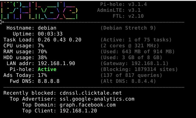

Look at the new screenshot:
So, you are able to access the Pi-hole? What is the issue then?
Well, there are no issue per se. I can now access pihole. You can close this thread and follow me at my other thread here.
