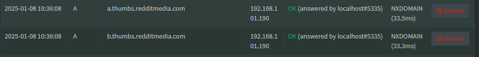

Domains not on blocklist are returning NXDOMAIN. Problem stops when I restart and returns a few days later
I am also using unbound 1.17.1
Expected behavior: Sites that are not on blocklist are resolved and loaded and sites that are on blocklist are blocked.
Sites that are not on my blocklist are not resolving. Not all sites, but a few random ones that I can't figure out. For instance:
This is returning NXDOMAIN when I expect it to load. When I reboot my Raspberry Pi, the sites start working again and returns CNAME for a reply but it only lasts about 48 hours before it starts happening again. I've even wiped clean my SD Card and done a fresh install of everything and I get the same results.

After raising verbosity to 2 and reloading the reddit page which is failing to load thumbnails, this is the log page:

I don't see the a.thumbs.redditmedia.com or b.thumbs.redditmedia.com in the logs which are the domains in question that are not having the expected results.
I am fairly confident that you'll see that NXDOMAIN is indeed the result provided by the authoritative DNS server - based on your unbound configuration, there is no reason to assume otherwise.
But how come this is only true after my pihole has been running for a few days? That domains resolves fine after I reboot, or when I choose a different upstream DNS server, or when I am not using pihole, or on my home pihole setup (as opposed to this one, which is my office setup, which also uses unbound). If you try to resolve a.thumbs.redditmedia.com or b.thumbs.redditmedia.com do you get an NXDOMAIN result? If not, then how could that been the true result of the authoritative DNS server?
Then chances are that replies for those domains are still cached by either Pi-hole or the requesting client itself. As both of those domains are CNAMEs referring to dualstack.reddit.map.fastly.net., it could be just those CNAMEs that are cached, and the log still seems related and representative for the actual A record lookup (with a shorter TTL than the CNAME) your observation.

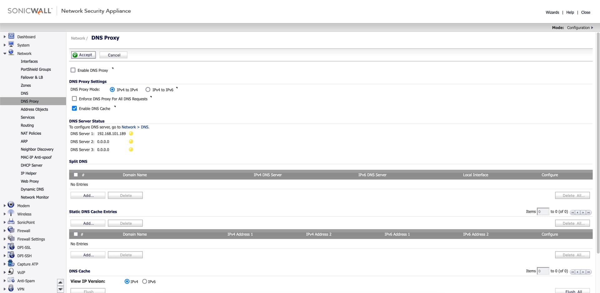

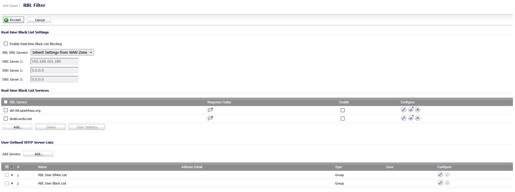

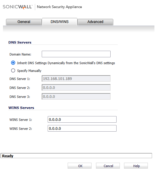

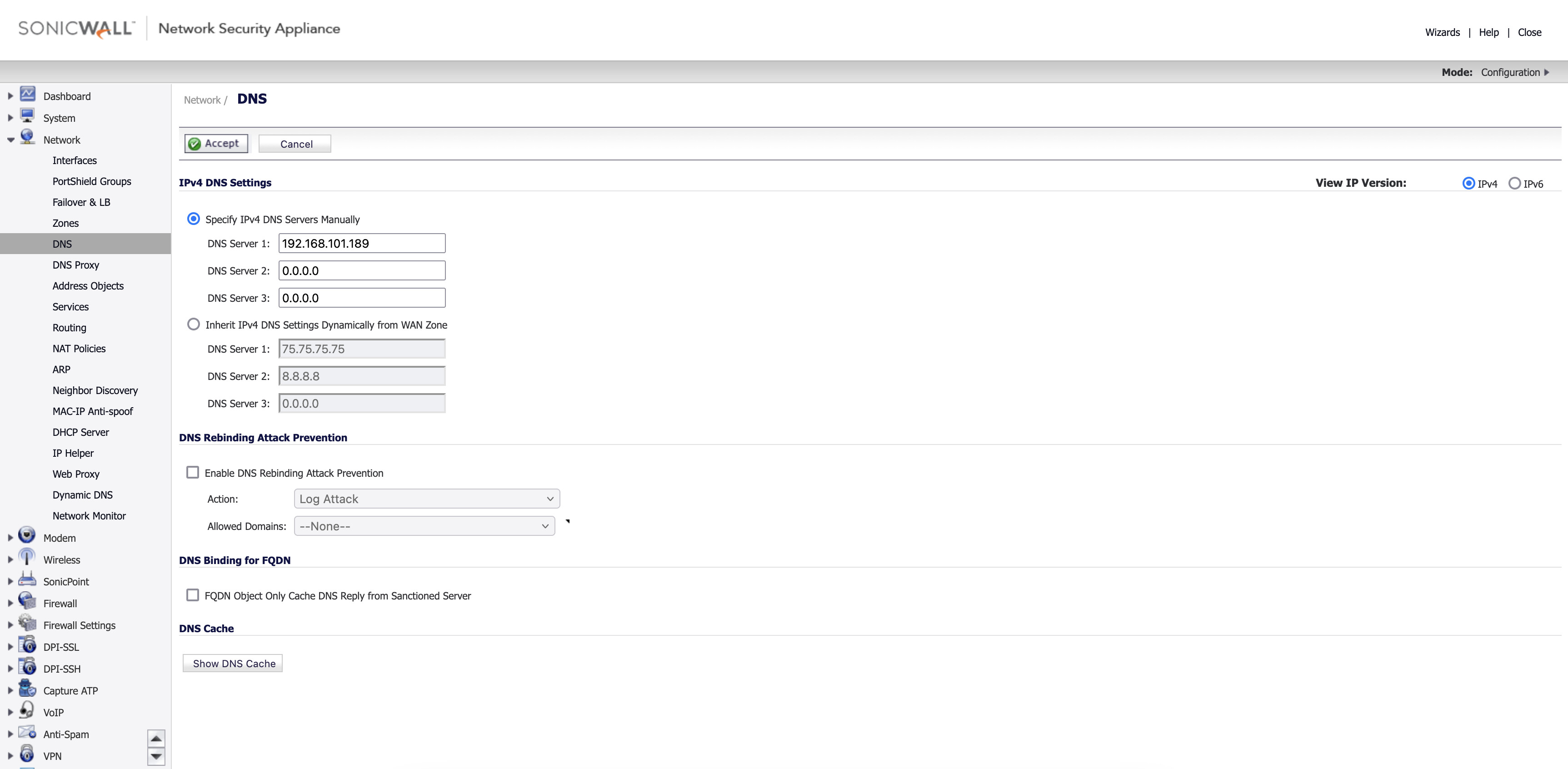

This would suggest that something upstream of unbound may be intercepting DNS traffic, so the answers you are seeing would not be originating from the root servers.
Do you run a firewall in your network, or would you route outbound public traffic through a VPN service provider?

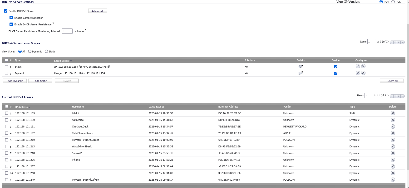

Hi, so I was away from my home network at the time I tested so I was running the tests at the time through a VPN and also there is a firewall on the network, so both were true at the time.
I reran the tests now that I'm back on the home network, so no longer using a VPN but yes there is an active firewall. Here are the new results:

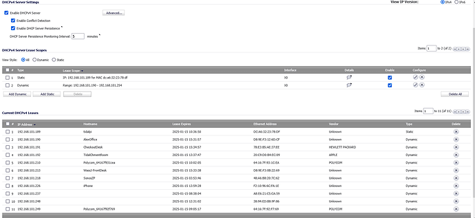

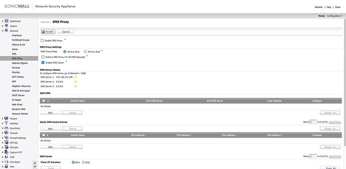

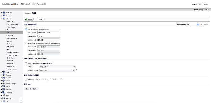

I have a SonicWall firewall and these are what I suspect the relevant DNS settings. It seems like everything seems OK? Is there some other settings I should check on the firewall? 192.168.101.189 is my Pihole.
I can't really comment on that, as I don't know that product at all.
Is that firewall also acting as your router/gateway?
If so, I'd wonder whether there would be a DHCP option for distributing a local DNS server pushed to DHCP clients, and whether that DNS pane you show concerns the firewall's upstreams (i.e. the DNS server the firewall itself would use), and I generally wonder what the DNS Proxy would be for.
Yes.
Here is the DHCP screen.
if I click the configure button to the right of the dynamic leases, it shows this screen. Considering what the DNS screen showed previously in my last reply, this seems okay, right?
As said before, I can't really comment on that, but I wonder whether that DNS pane would concern your firewall's upstreams (i.e. the DNS server the firewall itself would use), and I generally wonder what the DNS Proxy would be for.
You should consult your product's documentation for configuration details.
If that DNS pane is defining Pi-hole as your firewall's upstream, your DHCP settings would suggest that you'd be also be using Pi-hole as local DNS server, which may result in a DNS loop if Pi-hole would be sending DNS requests to your firewall, which may either happen when you define your firewall as one of Pi-hole's upstreams, enable Conditional Forwarding or have your firewall intercept DNS and redirect DNS to Pi-hole. I'd expect you to also observe a rate limit and/or max concurrent warning in Pi-hole for looping DNS requests, but only the latter redirect could explain your REC_LAMEs.

I think I may have solved the issue, and if I did, you were correct about it here:
I was looking through the firewall settings and found this.
Both of these "Real Time Blacklist" spam filters were enabled until just now. Currently the previously blocked images are loading, I will see if things remain good. Thank you very much for helping me with this.
Edit: Nevermind it didn't work :frowning:
