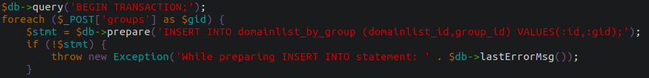

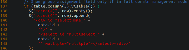

The problem is both pages/tabs Blacklist and Group management -> Domains
they both use the same groups-domain.js which looks like it is written specifically for Domains page.
When you toggle enable or disable, the Domains page supply the group id while Blacklist page
doesn't, thus this never get's executed in Blacklist or Whitelist
this is in groups.php line 510
So one solution could be to just copy-paste Domains table to both Blacklist and Whitelist page and adapt it.
Edit ok the table is pretty much the same missing a single column, group assignment, which is needed to provide the group id.
in groups-domains.js
My vim is messing up the git diff so im just gonna post the solution here. @DanSchaper
Only delete then insert group to domain associations if groups parameter is set.
line 496 in /groups.php add
if (isset($_POST['groups']) {
then in line 530 add (right after commit)
