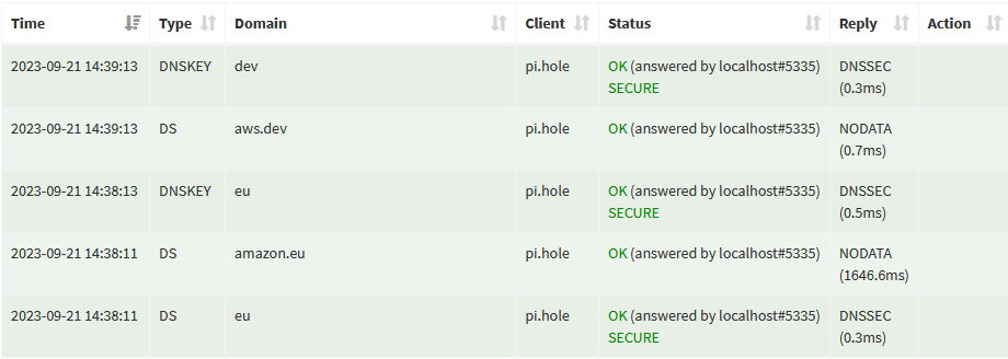

Hello!
I see these in my Query Log (filtered for pi.hole) and wonder what they are and why Pi-hole queries them:

Hello!

Basically, it's trying to verify the authenticity of the DNS records and querying the upper level domains to see if they have signed records. It's a chain of trust starting from the top level, like .com or .eu etc.
Ok, but why is Pi-hole itself checking for aws and amazon? I would understand it if some of my many other clients ask for these, but Pi-hole?
Pi-hole is checking those to try and verify the chain of trust for the DNS requests your network made.
Oh my bad - thank you so much for your patience! ![]()
Remembering that I run Pi-hole in combination with unbound, I think I now understand it (hopefully
). So whenever I see such queries from pi.hole, I should not worry, right?
Correct.
