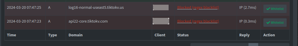

I have a domain-specific regex I am using to block "forbidden". I have assigned that regex to a group "cohort". i have assigned certain devices known to pi-hole to the group. Blocking works when the group is set to Enabled. However, even if the group is set to Disabled, the devices in this group are still being blocked by the "forbidden" regex. What am I missing?

The query log tells me plainly it is blocked by my regex blacklist.
