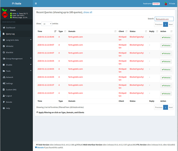

After upgrading to v5.0 the domain fonts.gstatic.com is blocked, which was never happening before. When I query the lists to find out which list is blocking it non is found. It is also not on my blacklist. Interestingly the reply column just contains '-' but on all other blocked entries '- (xx ms)'
Adding fonts.gstatic.com to the whitelist resolves to problem as a workaround.

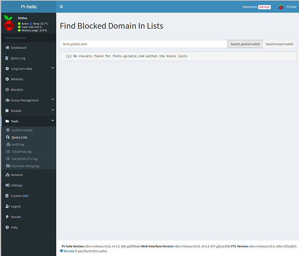

Does an exact match search bring up any lists? Pi-hole wouldn't know to block a domain unless it was on a list in some capacity.
No it doesn't (except for the whitelist now after adding it)
