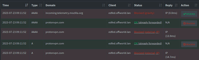

Domain blocked despite whitelist
Visit protonvpn.com that is whitelisted
Receiving browser message that the site is not secure. I have added the domain with wildcard to the Whitelist. Watching the log within Pi-hole WebUI displays that it is still being blocked. I can confirm that the site can be visited without issue by pointing my computer to a different external DNS server.
https://tricorder.pi-hole.net/xIf9XFxn/

Your browser's message does not seem related to Pi-hole:
As chrislph has pointed out, the browser already talked to protonvpn.com, i.e. it has succesfully resolved that domain and even retrieved that site's SSL certificate. When checking that, the browser concludes that there's something wrong with the certificate, rejecting access with NET::ERR_CERT_AUTHORITY_INVALID.
However, your Pi-hole's Query Log also shows that protonvpn.com has been blocked externally, i.e. by one of Pi-hole's upstream resolvers.
    PIHOLE_DNS_1=208.67.222.222
    PIHOLE_DNS_2=208.67.220.220
In that case, your browser would have resolved protonvpn.com through one of the additional DNS servers that your router is offering (as already mentioned by chrislph).

And the OpenDNS servers you are using as Pi-hole's upstream could have been incorrectly blocking that domain for a while (they don't block it currently).
Or, if you'd be using an OpenDNS paid subscription for configurable DNS filtering, your currently configured filters may have included that domain.

Yeah. My bad. I forgot I had put OpenDNS in the DNS Settings of my Pi-hole.
I've since changed from OpenDNS to Cloudflare and protonvpn.com site is now accessible without issues.
