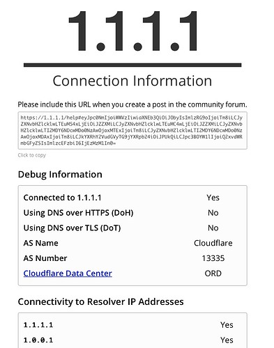

Test when I have Pi-Hole pointed directly to Cloudflare:

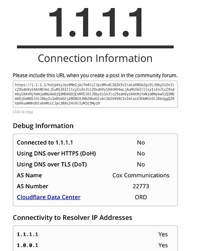

Moved DNS on this computer to another Pi-Hole running unbound (local resolver):

This from a Reddit user, who runs cloudflared DoH on 127.0.0.1#5053. He connected to the test site and found this:
Connected to 1.1.1.1 Yes
Using DNS over HTTPS (DoH) Yes
Using DNS over TLS (DoT) No

I'm having the same issue but disabling DNSSEC didn't change anything for me. Cloudflare's help site says No for everything except the bottom section, regardless.
