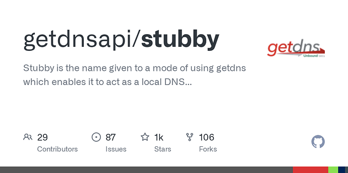

Use DoT, it's better.
As Dan noted, DoT is a better option than DoH. Both provide the encryption you seek.

@DanSchaper stated to use DoT and shared a github link and @jfb you shared the configuration for unbound to get started with DoT - would we need to be running both Stubby and unbound?
No.
