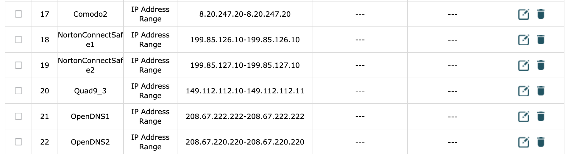

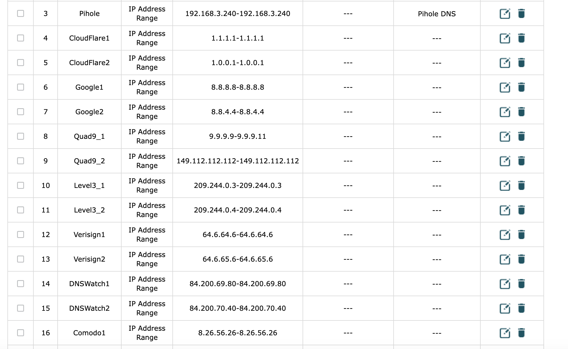

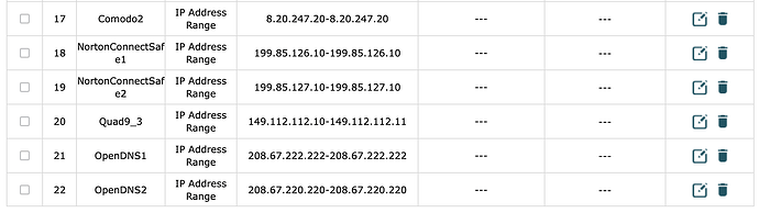

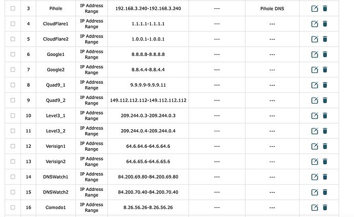

  1. Define IP addresses / ranges - Preferences -> IP Group -> IP Address (Tab), e.g. CloudFlare1, CloudFlare2, Google1, Google 2, etc. INCLUDING entries for the DNS servers that pihole uses. My list in the screenshots below include the DNS options in pihole and a few other "common" public DNS. Each entry is a "range" where the Starting and Ending IPs are the same, EXCEPT for Quad9_3 in the screen shot below. Also add an entry for the local IP address of your pihole machine
  2. Define a Group of DNS servers to BLOCK - Preferences -> IP Group and add the relevant external DNS server IPs from above to be blocked, INCLUDING the IPs of the DNS server that pihole uses
  3. Define a Group to ALLOW - Preferences -> IP Group and add the local IP Address of Pihole to be allowed
