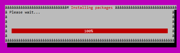

I've tried both one step automated installed as well as got clone methods, in both cases everything appears to be normal until the last step Installing packages
Please wait ...
Then shows red 100% progress bar and I'm dropped to shell with no messages whatsoever.

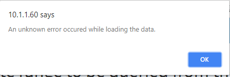

however there is no process running, and the dashboard still sees no FTL

Package configuration
   âââââââââââââââââââââââââââ⤠Installing packages ââââââââââââââââââââââââââââ
   â Please wait...                                                            â
   â                                                                           â
   â                                                                           â
   â                                                                           â
   â                                   100%                                    â
   â                                                                           â
   âââââââââââââââââââââââââââââââââââââââââââââââââââââââââââââââââââââââââââââ
Thanks in advance

# sudo apt upgrade
Reading package lists... Done
Building dependency tree
Calculating upgrade... Done
0 upgraded, 0 newly installed, 0 to remove and 0 not upgraded.
Thanks
I believe some repo's were updated.
Can try install again and see if the packages get installed ?
If no luck, you can try install those packages manually and see what happens:
sudo apt install netcat idn2 sqlite3 dns-root-data
If they get installed successfully, you could try install Pi-hole again.
Thanks again @deHakkelaar
netcat idn2 and sqlite3 installed fine
dns-root-data didn't
apt install dns-root-data
E: Unable to locate package dns-root-data
Thanks
cd ~
wget http://ca.archive.ubuntu.com/ubuntu/pool/main/d/dns-root-data/dns-root-data_2018013001~17.10.1_all.deb
sudo dpkg -i 'dns-root-data_2018013001~17.10.1_all.deb'
apt-cache policy dns-root-data
You are awesome, thank you thank you thank you.
That did it, it's working now :slight_smile:
As I just started playing with this amazing service, I noticed couple of things (most likely due to my inexperience, but worth mentioning)
When I go to:
Long Term Data | Query Log
I get this popup.
Not sure if this has anything to do with the fact that I still don't have long term data, but the message does not sound right.
Also I switched my Upstream DNS Server to Quad 9 so that I can use DNSSec, enabled DNSSec, but the DNSSec test still fails
Thanks again.
echo ">stats" | nc -v localhost 4711
Yeah could be.
Give it a little time.
Cant help you with the DNSSec but am sure someone else can.
EDIT: ohw by running the pihole-FTL binary manually previously, you might have created a database file belonging to the wrong user.
Check ownership:
pi@noads:~ $ stat /etc/pihole/pihole-FTL.db
Access: (0644/-rw-r--r--)  Uid: (  999/  pihole)   Gid: (  996/  pihole)
If not owned by user/group pihole/pihole, delete the file with:
sudo rm /etc/pihole/pihole-FTL.db
And restart pihole-FTL with:
sudo systemctl restart pihole-FTL
Thanks for all the assistance you provided, it's priceless.
