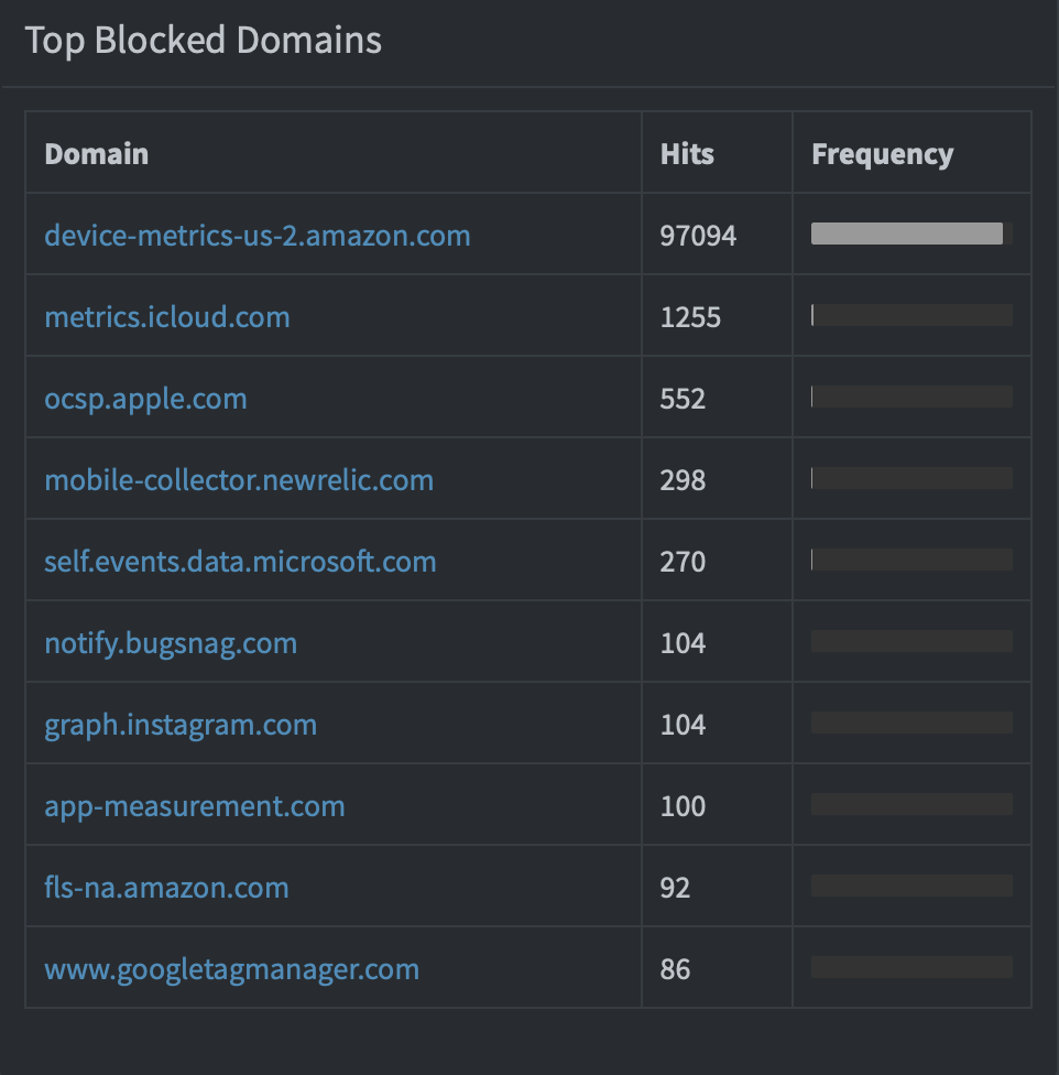

The excessive Phoning home on echo dots is due to the domain being blocked. So right now it tries to phone home at a rate of 20hz which is excessive I don't want the traffic to go to amazon but blocking it seems like the wrong approach since it just makes the client try to phone home more and more. Not sure if changing the blocking mode will make the client try to phone home less often but right now it generates a lot of traffic on the network

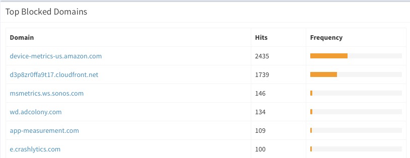

That seems a lot. I have a handful of Echo devices on my network and block the domain device-metrics-us.amazon.com with a different result. The devices query once every few minutes.
24 hour total with seven Echo devices active.
This is with one echo device that is used once in a blue moon
That's a lot of queries. I don't have a good solution for you.
