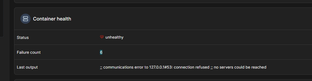

I restored my pi-hole v5 backup on a new pihole v6 docker.

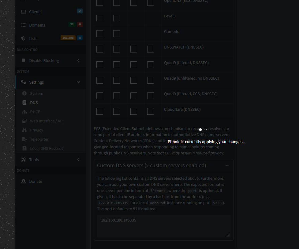

then I went to change the unbound address from 127.0.0.1 to 192.168.180.1
and the webinterface stops working and portainer mentiones unhealty.
restarting the container seems to fix this issue.

Can you replicate the issue with a fresh container? If so, please post a debug token.
Do you see any errors in Portainer logs?
If you didn't remove the container yet, go to the Portainer interface, select Containers, find your Pi-hole container and click on the log icon:
If there are error messages, click on the "Copy" button and paste the logs here.
I didn't remove the container but unfortunately my logs don't go back that far.
One thing I found out after posting this was that unbound on the remote machine was listening on the wrong port making the DNS server unavailable for pi-hole.
