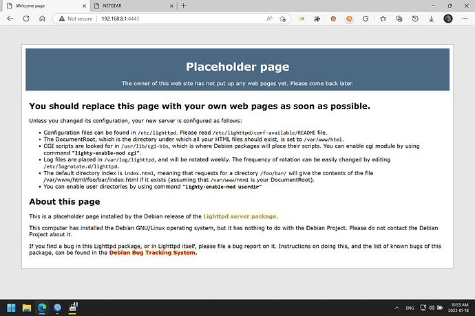

I follow instruction to install container on this video https://youtu.be/UMcJs4oyHDk to use pihole but when I write to my MK ip (192.168.8.1:888) on browser the pihole page not open or i got this
I need your help please
with regards
Append /admin to the URL.
Alternatively, set the environment variable FTLCONF_LOCAL_IPV4 to 192.168.8.1, and it should automatically redirect

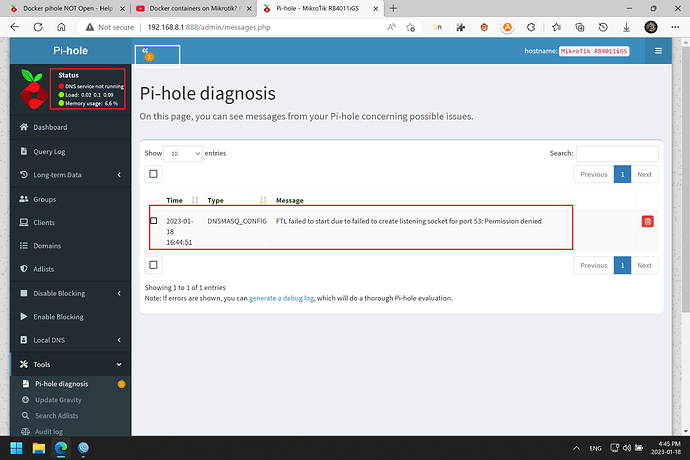

thank its work but with error
You can try setting the env variable DNSMASQ_USER to root - that is a requirement on some systems.
See the README here for a list of the environment variables that you can use

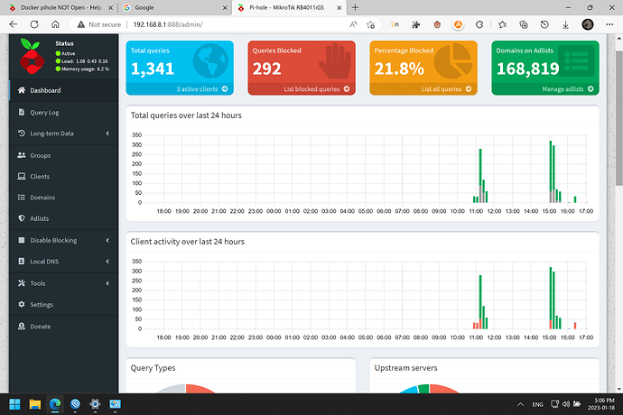

PromoFaux THANK YOU SO MUTCH it's WORKING NOW
as I mention that I have Huawei 5G router which is connected to MK RB5009
NO ONE even mention that I have to change the DNS from Huawei router to Pihole DNS
The router configuration is mentioned on the Documentation:
Post-Install: Post-Install - Pi-hole documentation
