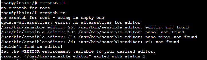

I was planning on using crontab to setup a time based DNS Filter, but when I try to edit crontab, I get the following error:
crontab -e
update-alternatives: no alternatives for editor
Is contab supported inside of docker?

You are missing (as stated) a text editor...
Install one of those and you'll be able to edit the crontab file.
I think nano will work good for you ...
Keep in mind that when and if the docker image is updated, your editor will be gone ...
