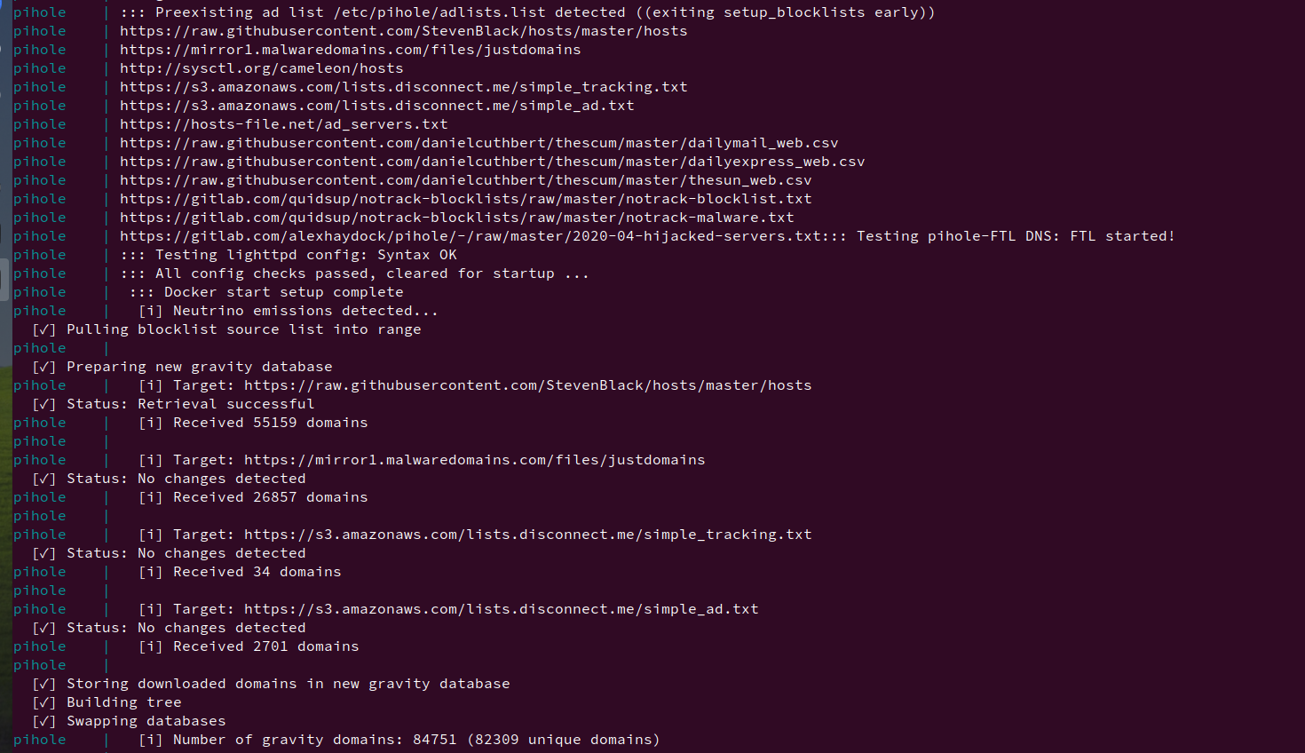

Currently I build my own image by taking pihole/pihole:v4.4 and adding an adlist file with COPY adlists.list /etc/pihole/adlists.list. This has worked very well for a long time. The container reads the file on startup and fetches the right lists into the Gravity database.
Until a few days ago this worked for the pihole/pihole:beta-v5.0 container too, but in the past few days it has stopped working. I understand that the only reason this worked in the first place is due to a "migration" feature where v5.0 is able to "import" the old format lists from v4, and that this feature might go away eventually, but nonetheless doing it this way worked well for now.
As you can see from above, the container does correctly find and identify the ad-lists in my adlists.list file, but then in the "Preparing new gravity database" step, it goes on to pull in only the default lists anyway.
I've looked through the beta branches for both Pi-Hole and for the Docker Container on GitHub and I can't identify any recent commits which might obviously have broken this import step.
