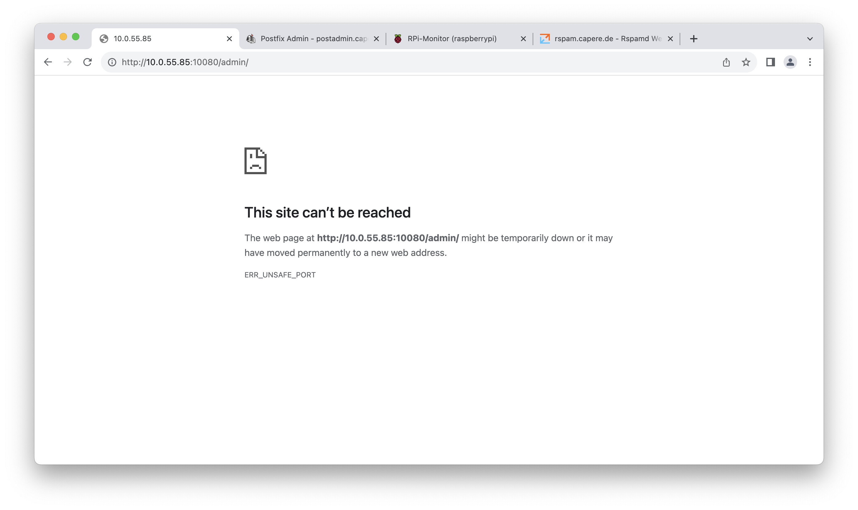

And the screenshot from chrome:
As you can see the curl looks promising but no way to open the url in chrome or any other browser. Regardless which machine.
The curl shows that lighttpd is providing all of the content, headers and information that it is set up to do. So the issue isn't there, Pi-hole is fully functional. (Note the X-Pi-hole header for confirmation.)
I think your issue is with the browser or the underlying OS. Note the very last line of the page display: ERR_UNSAFE_PORT which is Chrome telling you that it is blocking your access to http on port 10080. There's a few options that show up from a quick web search on that error, how you wish to address it is up to you.
...just read about the ALPACA attack....this seems to be related to port 10080 what a shame...so problem solved
If you'd stick with port 10080, you'd have to take it up with G**gle's developers then:
They are the ones deciding which ports to consider unsafe:
// The general list of blocked ports. (...)
const int kRestrictedPorts[] =  = {
    1,      // tcpmux
    10080,  // Amanda
(source: Chromium /net/base/port_util.cc)
