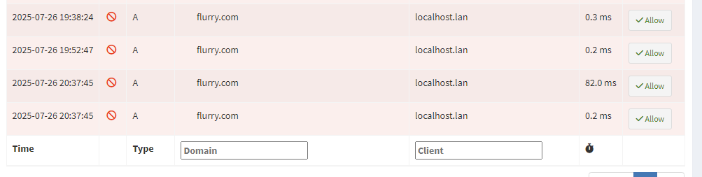

Checking the query log appears to be destroying performance:
Load: 3.62 / 5.51 / 9.75
Memory usage: 70.5 %
and it keeps timing out my remote connection (I should probably setup SSH instead of using RPI connect but it's so much easier when it works :p)
It looks like it's blocking them but that's not enough queries for the 5-6 times I regularly issued the query from the cmd line so I'm a bit confused, and in all those cases the cmd line was coming back with ' communications error to 127.0.0.1#53: timed out'

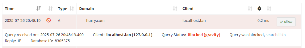

6.8s to get a response
Which shows in the query log as blocked
but with a much faster query time at the resolver end
Ah, sorry, my fault - of course flurry.com is blocked, so upstreams cannot be involved here.
This is unexpected.
There is no obvious reason why a lookup of a blocked domain should take almost 7 seconds - it should return instantly (as the 0.2ms from the Query Log).
Interestingly, the timeout for Pi-hole's dhcp-discover is 6 seconds.
This means that a delay of more than 6 seconds on IPv4 traffic could also explain why we don't see a DHCP server response in the debug log, despite Pi-hole being that DHCP server.
