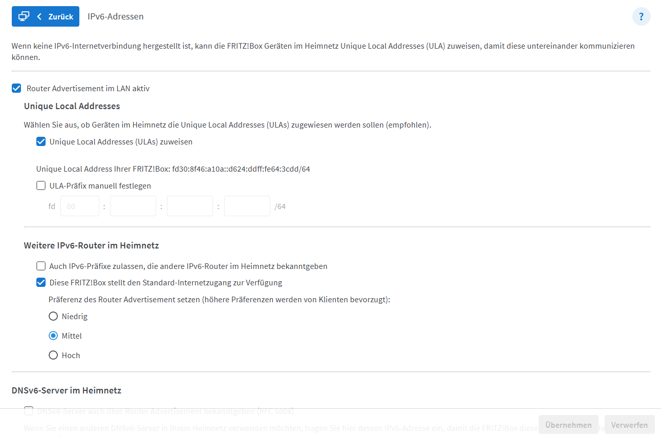

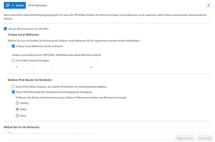

Could you please share a screenshot of your Fritzbox screens with your IPv6 configuration for DNSv6-Servers/DHCPv6-Servers?

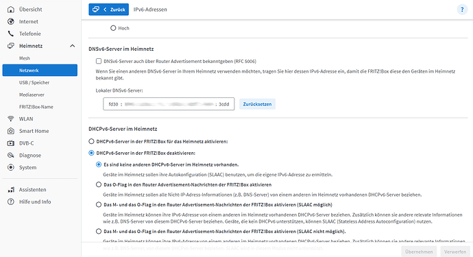

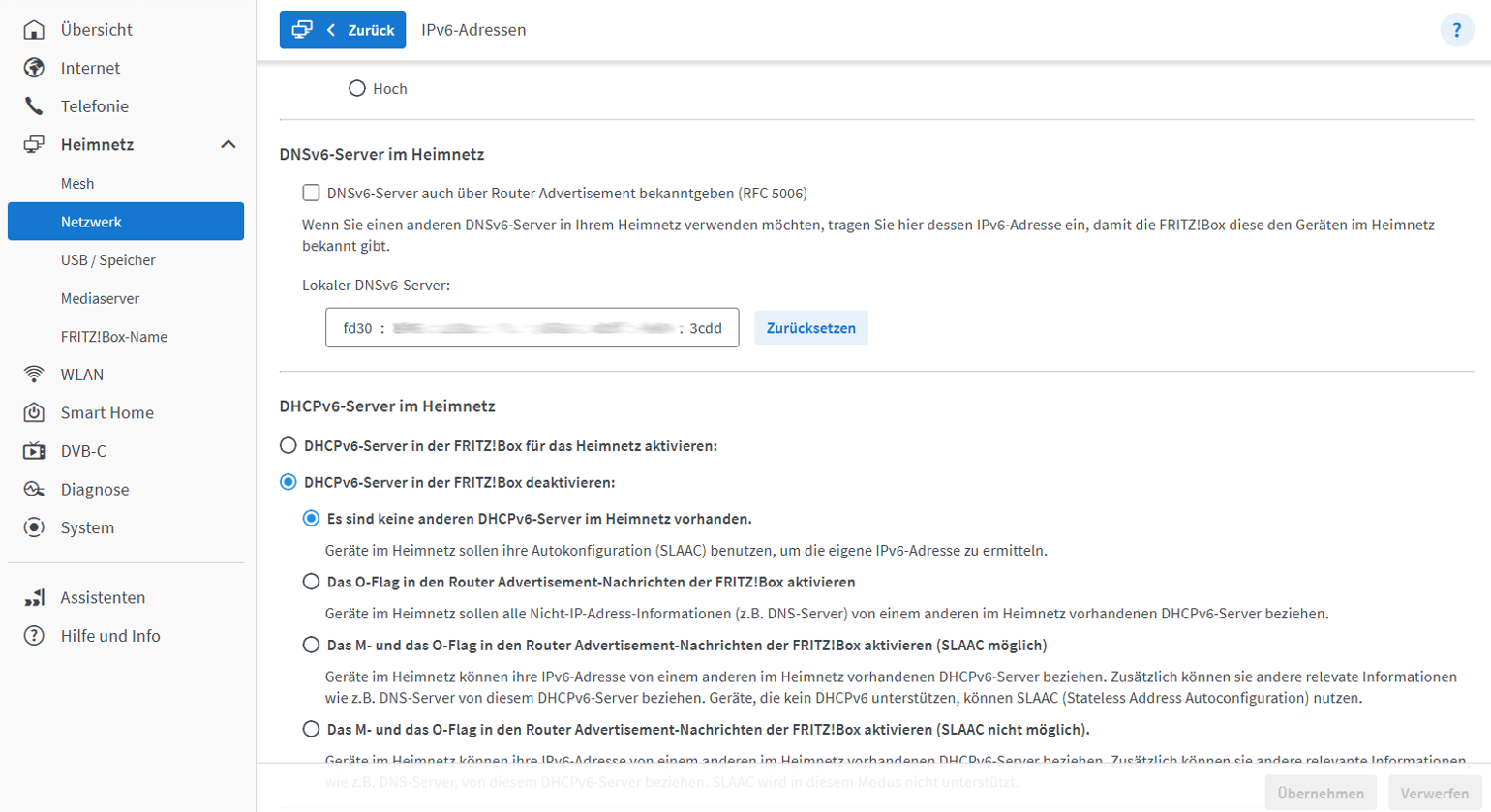

I re-enabled DNSv6-Server auch Ăźber Router Advertisement bekanntgeben (RFC 5006) and set the IPv6 of my pihole/NAS as the Local DNSv6-Server.
(This settings only, resulted in addiotionally showing the pihole IPv6 as DNS servers. My PC still defaulted to the fritzboxs IPv6.)
So I also set:
  • DHCPv6-Server in der FRITZ!Box fĂźr das Heimnetz aktivieren:
  • Nur DNS-Server zuweisen
(After ipconfig /release… /renew … /flushdns… /all, I only got the piholes/NAS IPv6 and Ipv4 shown as DNS servers :partying_face: .

I also set the upstream DNSv4 and DNSv6 servers of the fritzbox to the piholes IPv4 and IPv6 address. But I guess this was not necessary to get this working. (Might be a nice redirect for clients asking the fritzbox directly?).

Your screenshots show that you've correctly disabled your router's DHCPv6 server as well as its RAs.
This would preclude that your Windows PC could have received an answer for its DHCPv6 requests for DNS information - unless your Fritzbox unexpectedly and wrongly would have answered those.

Try to configure your Pi-hole machine's ULA as Local DNSv6 server in your Fritzbox and enable RDNSS RAs via Also announce DNSv6 server via router advertisement (RFC 5006) as well as DHCPv6.
Would your Windows machine pick up that ULA address?
What happens if you then disable RDNSS RAs and DHCPv6 again?
I'd hope for Windows to overwrite its old IPv6 DNS servers with the new one, so at least it would no longer use your Fritzbox router for DNS.

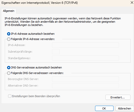

Ethernet adapter settings were on automatic the whole time:
So that is the problem? Somehow one DNSv6 server keeps showing up.
