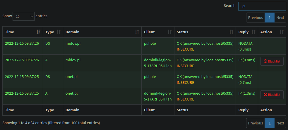

Looking in my 7 days querey log, it seems as if all .pl domains have a problem.

thanks for the answer.
Yes, the unbound and the pi-hole having dnssec validation enabled.
As said, my dns resolvers are in line -> pi-hole (192.168.40.2) -> OpenWrt dnsmasq (192.168.4x.1) -> OpenWrt unbound (127.0.0.1:5053, qname minimization) -> ...
dnssec validation works well, except for midov.pl and onet.pl. Other in .pl are correct and listed as either insecure or secure, but not bogus. Only midov.pl and onet.pl are listed bogus by pi-hole. But both are resolved correctly by Openwrt unbound.
I don't have a clue what is causing this. Restarting (clearing cache) didn't help either.

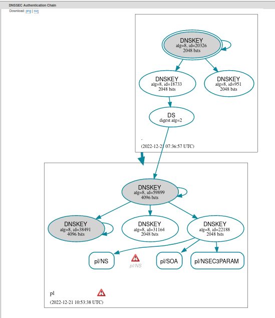

Looking on dnsviz for midov.pl I see that there are two setups side by side. It's also showing in the log that I get two RRSIG. May there be any problem by maybe fetching the wrong RRSIG under what? circumstances?

OK, it is now happening again.
I also found a few mysterious entries in pi-hole where querying an AAAA record is listed multiple times with always NODATA as result, but every second line either INSECURE or SECURE.
I would argue that there is some cache problem. I need to find screenshots and log output tomorrow.
I will now blame .pl for all of this ... even though it might also be a problem in the chain of my dns resolvers but as
  • it is only .pl domains and
  • everything else (and for other domains) works fine

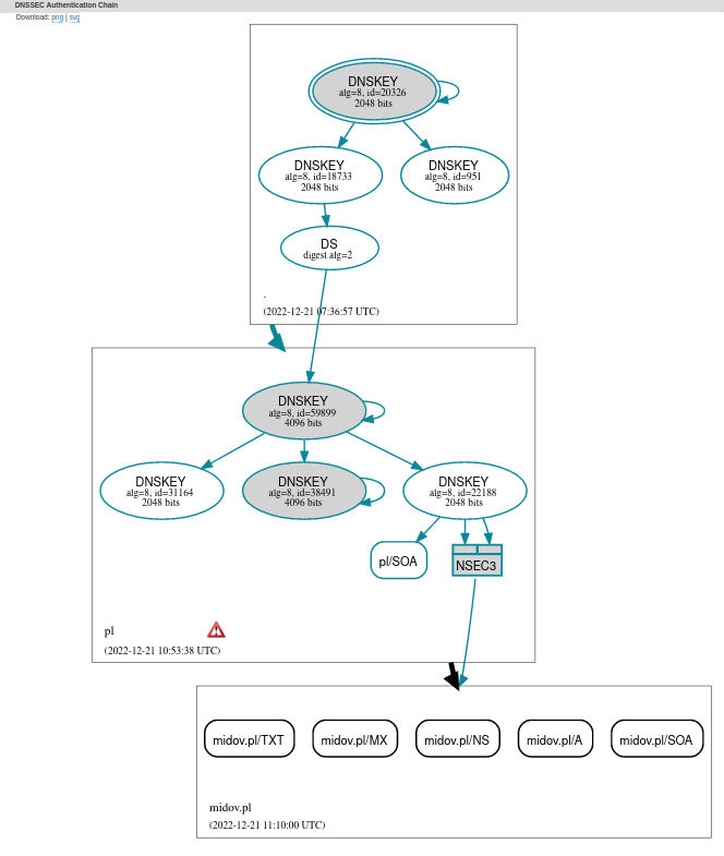

having a look on dnsviz.net for midov.pl I see a number of changes starting 2022-12-08.
This is 2022-08-28:
This is a picture on onet.pl from 2022-12-08
and now
I assume the changes together with caching is causing my troubles.
