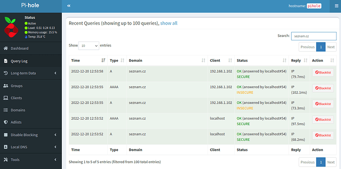

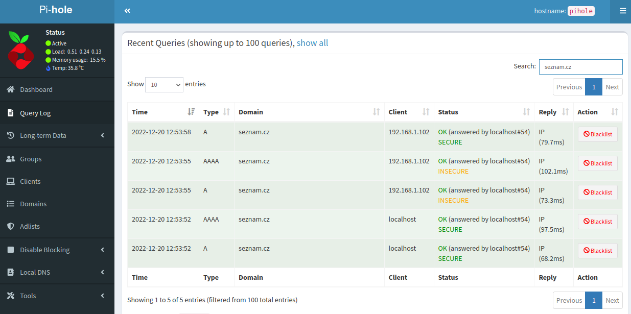

The issue I am facing:

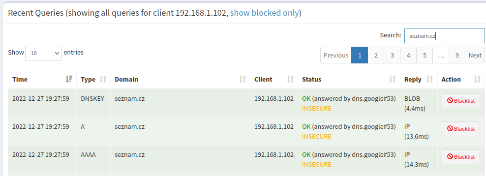

When a (remote) Pi-hole client (192.168.1.102) ask for DNS resolution, queries are marked as INSECURE.
When I ask for the same domain locally from the system where Pi-hole runs (localhost), the query is marked as SECURE.
When I use dig to from the client (192.168.1.102), the query is marked as SECURE as well.
The log above shows:
  • 2022-12-20 12:53:52 - "$ ping seznam.cz" from Pi-hole system (localhost) - Status SECURE
  • 2022-12-20 12:53:55 - "$ ping seznam.cz" from client (192.168.1.102) - Status INSECURE
  • 2022-12-20 12:53:58 - "$ dig seznam.cz" from client (192.168.1.102) - Status SECURE

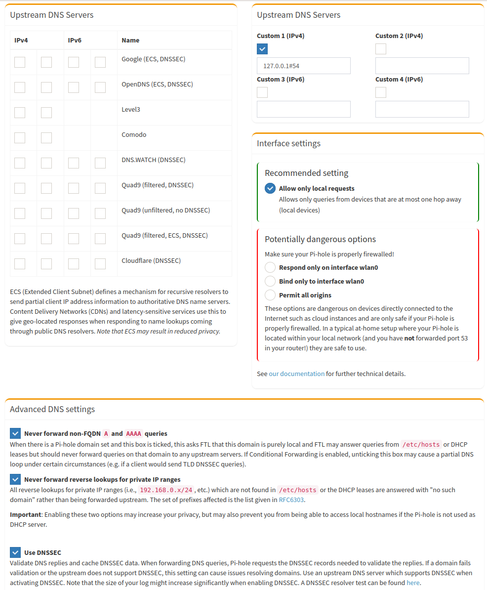

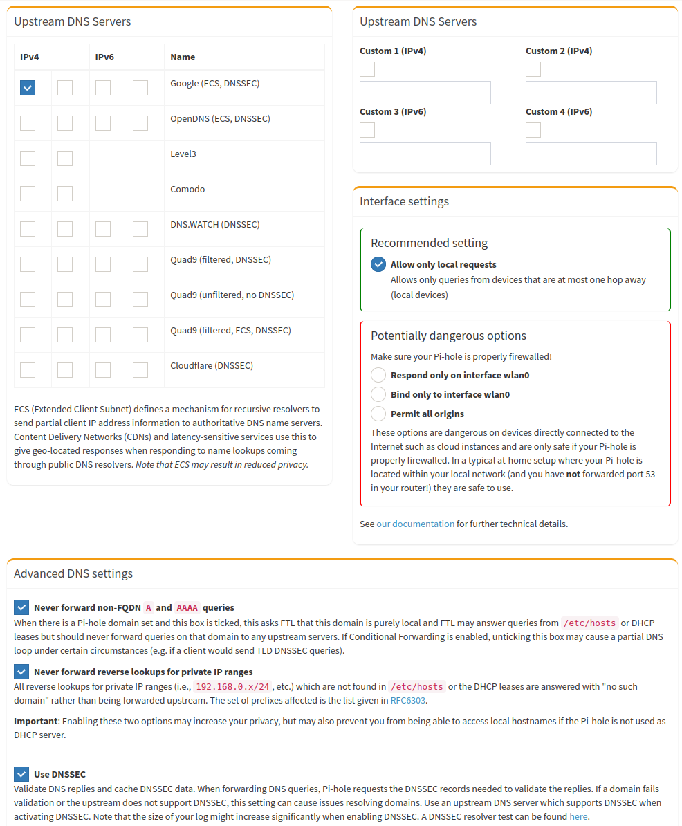

  • Pi-hole is running on RPi Zero with IP 192.168.1.224, listening on the default port 53.
  • Pi-hole has "Use DNSSEC" enabled.
  • Pi-hole has only one upstream DNS server configured (and none of the predefined is enabled).
  • The only DNS configured in the Pi-hole configuration is "127.0.0.1#54".
  • I'm using DoT (DNS over TLS) via Stubby running locally on the same RPi and listening on port 54, that's why the queries in the log are answered by the localhost#54 DNS on the screenshot above.
  • The Stubby is configured to use Open DNSSEC Validating Resolvers from CZ.NIC (Czech Domain Administrator) via the DoT [1].
  • The Stubby is also configured to validate DNSSEC.

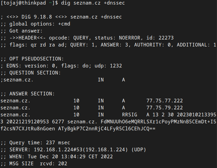

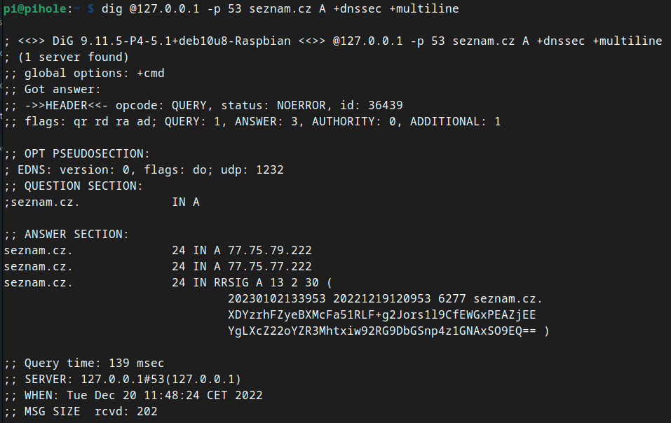

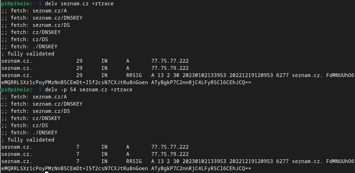

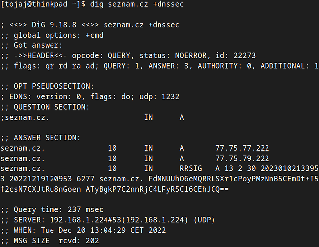

Testing DNSSEC on the Pi-hole system via Delv and Dig confirms that answers from the Pi-hole as well as from the Stubby are DNSSEC validated:
Using Dig from the client in question (192.168.1.102), shows that the answer is DNSSEC validated:
See "ad" (Authenticated Data) flag in the header response, "do" (DNSSEC OK) flag and the RRSIG record all present in the dig output on the client.

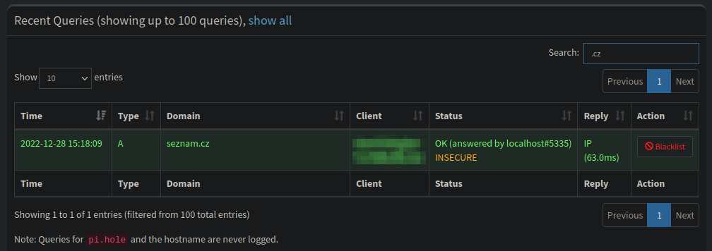

I still see the issue for that Linux (Fedora 37) host, its queries are always INSECURE
But queries from an Android phone or Samsung TV are returning SECURE.
Maybe the problem is not in the Pi-hole but in that Linux client.

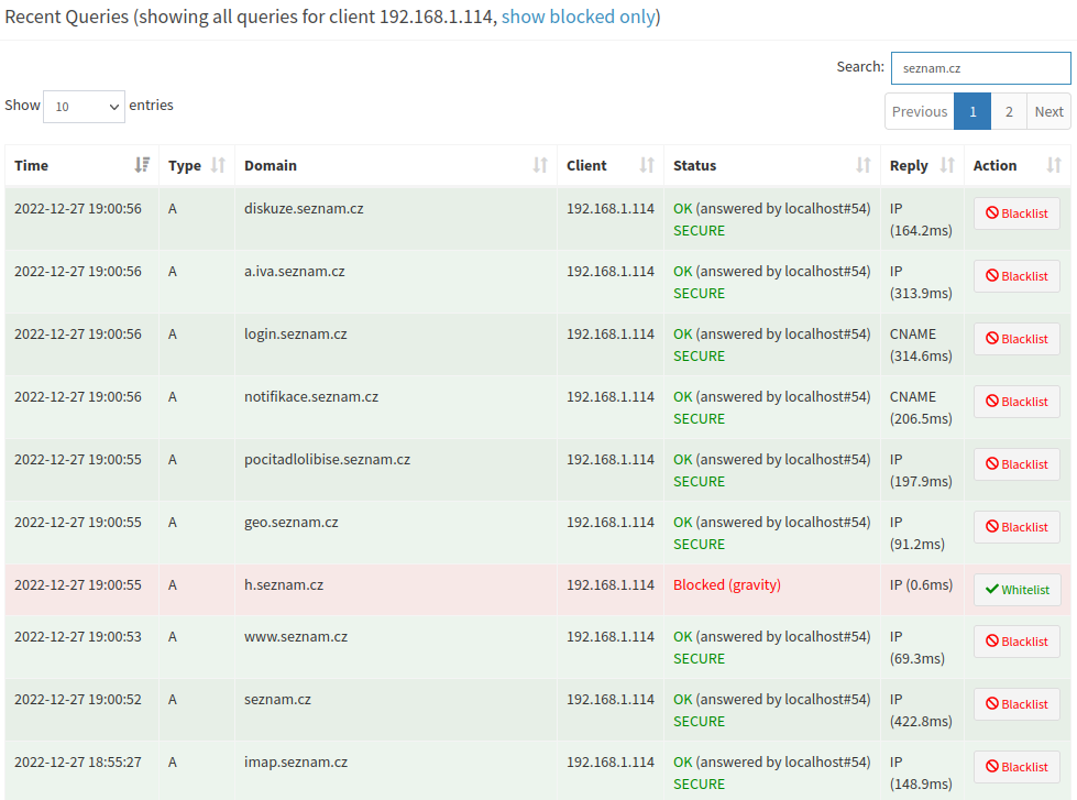

Ok, I've just done some testing.
In the :one: first part, I kept my current configuration (with local stubby on port 54 as the only DNS configured in the Pi hole).
In the :two: second part, I used the google DNS (as predefined in the Pi hole config).
I did the testing with the Fedora 37 host (192.168.1.102) and with Android phone (192.168.1.114).
  • On the Fedora 37 (192.168.1.102), I run these three commands - "ping -c1 seznam.cz; dig seznam.cz; dig seznam.cz +dnssec"
  • On the Android phone (192.168.1.114), I was loading the seznam.cz homepage in web browser.
:one: [ORIGINAL CONFIG]
:one: :iphone: [Original config] Android phone (192.168.1.114) - SECURE
Capture command:

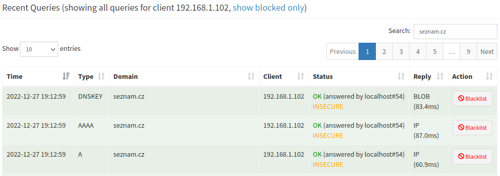

:one: :computer: [Original config] Fedora 37 (192.168.1.102) - INSECURE
[tojaj@thinkpad ~]$ ping -c1 seznam.cz; dig seznam.cz; dig seznam.cz +dnssec
PING seznam.cz (77.75.77.222) 56(84) bytes of data.
64 bytes from www.seznam.cz (77.75.77.222): icmp_seq=1 ttl=54 time=8.46 ms
--- seznam.cz ping statistics ---
1 packets transmitted, 1 received, 0% packet loss, time 0ms
rtt min/avg/max/mdev = 8.457/8.457/8.457/0.000 ms
; <<>> DiG 9.18.8 <<>> seznam.cz
;; ->>HEADER<<- opcode: QUERY, status: NOERROR, id: 26911
;; flags: qr rd ra ad; QUERY: 1, ANSWER: 2, AUTHORITY: 0, ADDITIONAL: 1
; EDNS: version: 0, flags:; udp: 65494
;seznam.cz.			IN	A
seznam.cz.		28	IN	A	77.75.77.222
seznam.cz.		28	IN	A	77.75.79.222
;; Query time: 1 msec
;; SERVER: 127.0.0.53#53(127.0.0.53) (UDP)
;; WHEN: Tue Dec 27 19:13:00 CET 2022
;; MSG SIZE  rcvd: 70
; <<>> DiG 9.18.8 <<>> seznam.cz +dnssec
;; ->>HEADER<<- opcode: QUERY, status: NOERROR, id: 20214
;; flags: qr rd ra ad; QUERY: 1, ANSWER: 3, AUTHORITY: 0, ADDITIONAL: 1
; EDNS: version: 0, flags: do; udp: 65494
;seznam.cz.			IN	A
seznam.cz.		28	IN	RRSIG	A 13 2 30 20230108070320 20221225053320 6277 seznam.cz. PkqA7Ify4DsgWxSKp2kSCpmNILHSZm9s5tTZ+pKssrRif3/CgJw2onZv JFgauZ5Jr5ABmCtBlWFGjpnkl8KtWw==
;; MSG SIZE  rcvd: 175
Note that for all three commands, there was only one DNS query (I believe this may be ok).
Capture command:
pi@pihole:~/tcpdump $ sudo tcpdump -n -s 1500 udp and port 53 and host 192.168.1.102 -w dns-traffic-rpi-pi-hole-fedora37.pcap
tcpdump: listening on wlan0, link-type EN10MB (Ethernet), capture size 1500 bytes
^C16 packets captured
23 packets received by filter
0 packets dropped by kernel
PCAP file:
dns-traffic-rpi-pi-hole-fedora37.pcap (3.5 KB)

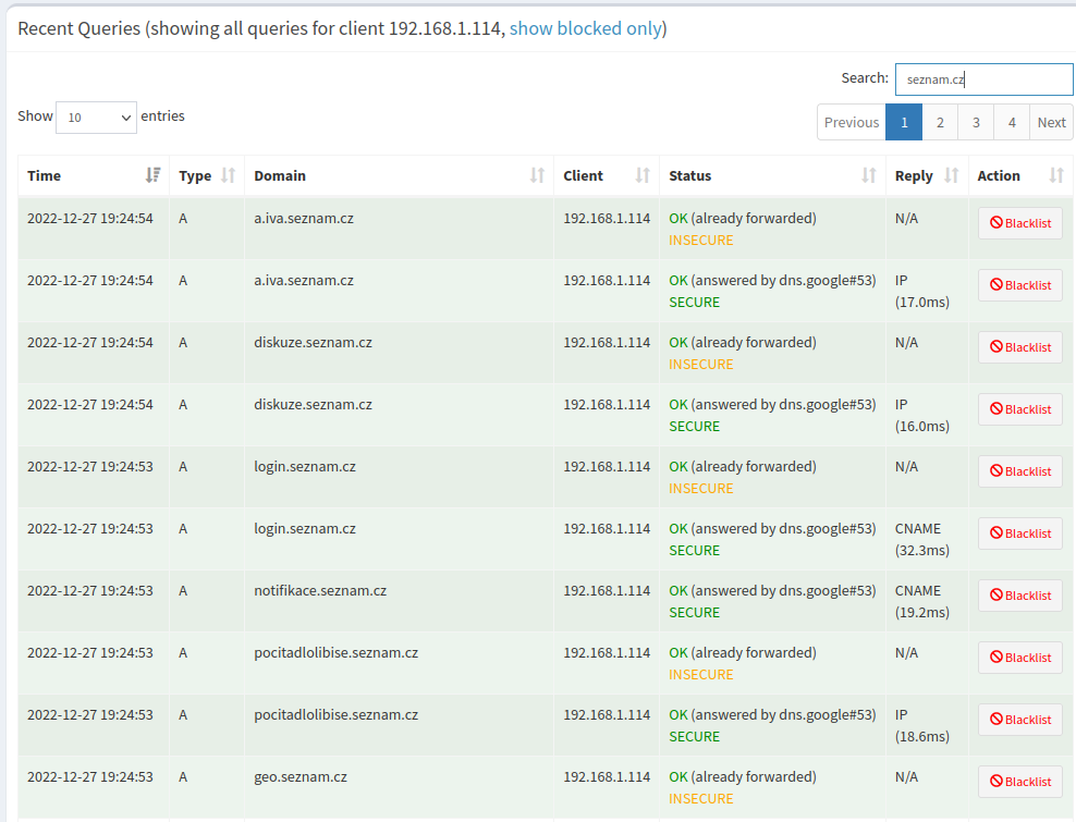

:two: [GOOGLE DNS]
:two: :iphone: [Google DNS] Android phone (192.168.1.114) - Mix od SECURE and INSECURE
Capture command:
pi@pihole:~/tcpdump $ sudo tcpdump -n -s 1500 udp and port 53 and host 192.168.1.114 -w dns-traffic-rpi-pi-hole-google-androidphone.pcap
^C78 packets captured
96 packets received by filter
PCAP file:
dns-traffic-rpi-pi-hole-google-androidphone.pcap (8.4 KB)
:two: :computer: [Google DNS] Fedora 37 (192.168.1.102) - INSECURE
64 bytes from www.seznam.cz (77.75.77.222): icmp_seq=1 ttl=54 time=11.5 ms
rtt min/avg/max/mdev = 11.454/11.454/11.454/0.000 ms
;; ->>HEADER<<- opcode: QUERY, status: NOERROR, id: 44420
;seznam.cz.			IN	A
seznam.cz.		6	IN	A	77.75.77.222
seznam.cz.		6	IN	A	77.75.79.222
;; Query time: 0 msec
;; WHEN: Tue Dec 27 19:28:23 CET 2022
;; ->>HEADER<<- opcode: QUERY, status: NOERROR, id: 28824
;seznam.cz.			IN	A
seznam.cz.		6	IN	RRSIG	A 13 2 30 20230108070320 20221225053320 6277 seznam.cz. PkqA7Ify4DsgWxSKp2kSCpmNILHSZm9s5tTZ+pKssrRif3/CgJw2onZv JFgauZ5Jr5ABmCtBlWFGjpnkl8KtWw==
Note that for all three commands, there was again only one DNS query.

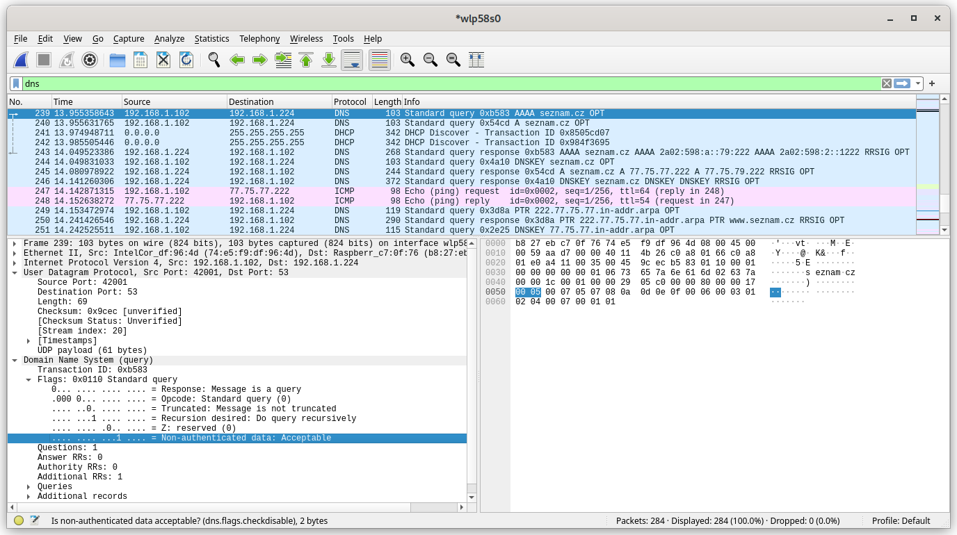

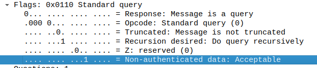

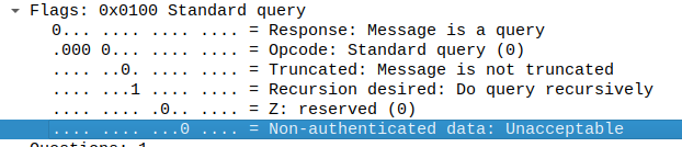

Okay, thanks for that. The answer is indeed found in the pcap files:
The Android phone says: DNSSEC validation is necessary, non-authenticated data is unacceptable (emphasis on the highlighted line):
This is the default behavior of virtually any DNS client on this planet, well ... except ... your Fedora, apparently.
Your Fedora client says: DNSSEC validation is optional, non-authenticated data is acceptable:
This bit is called the "CD bit". It is defined in RFC 2535 Domain Name System Security Extensions, Section 6.1:
The CD (checking disabled) bit indicates in a query that Pending (non-authenticated) data is acceptable to the resolver sending the query.
Even more, the bind documentation says some words about it, but it is best summarized in man dig :
+[no]cdflag
Set or do not set the CD (checking disabled) bit in the query. This requests the server to not perform DNSSEC validation of responses.
(emphasis on the last sentence)
Indeed, we can now reproduce this behavior reliably just by setting the CD bit explicitly (this dig command is even reproducing the exact query of your Fedora client hence the other options):
dig seznam.cz +cdflag +bufsize=1472 +nocookie +dnssec +ednsopt=5:0507080a0d0e0f +ednsopt=6:010204 +ednsopt=7:01
Code-wise is this realized by:
and then
TL;DR: Everything is behaving as expected and designed. The client excplicitly requested data not to be checked - which is nothing else than INSECURE in Pi-hole
This can be understood as a measure to reduce DNS latency while throwing caution to the winds. DNS data will be returned faster (no validation is done + no DNSSEC chain is validated, triggering possibly further queries along the way) Interestingly, my local Fedora system 37 doesn't do this.

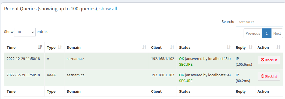

@DL6ER thank you!
My resolved config on the Fedora was:
$ grep -i dnssec /etc/systemd/resolved.conf
DNSSEC=allow-downgrade
A man page for the config file:
$ man resolved.conf
says:
If set to "allow-downgrade" DNSSEC validation is attempted, but if the server does not support DNSSEC properly, DNSSEC mode is automatically disabled.
Anyway, I went and restored the default resolved.conf file:
$ rpm -qf /etc/systemd/resolved.conf
systemd-resolved-251.10-588.fc37.x86_64
$ sudo rm /etc/systemd/resolved.conf
$ sudo dnf reinstall -y systemd-resolved
$ rpm -V systemd-resolved
# No output here, which confirms that rpm version of the config file is installed now.
$ sudo reboot

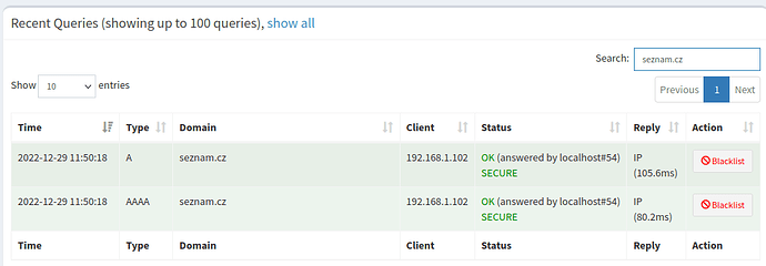

After the restore and reboot, the answers for Fedora host are SECURE:

I checked the "DNSSEC=yes" resolved behavior on the packet level with Wireshark the same way as @DL6ER:
I confirm to see that resolved says non-auth data are acceptable, however I noticed, that resolved is also asking for DNSKEY records so my assumption is that even when resolved is asking DNS to provide non-auth response, it (resolved) does the DNSSEC validation locally on its own, see the "Data is authenticated: yes" here:

-- Information acquired via protocol DNS in 436.9ms.
-- Data is authenticated: yes; Data was acquired via local or encrypted transport: no
-- Data from: network
(This above query was logged in the Pi hole log as INSECURE although resolved says it's authenticated)
