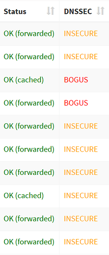

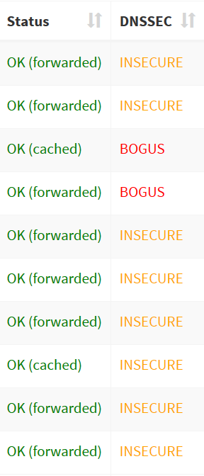

Yet, the test page continues to show DNSSEC is not working. Here is a small sample from my log:
Can someone please help figure this out.
Thank you.
While this doesn't help @diameter, I can report that the DNSSEC test page gives me a positive result with my server setup (see post above).
Interestingly, the pi-hole sites themselves are currently classified as INSECURE.
INSECURE means that the domain isn't set up with DNSSEC, and BOGUS means the record has been changed (doesn't match signature). Do you see any SECURE entries, or any domains which are supposed to be secure showing as INSECURE?
