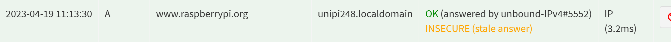

compiled the unbound branch with caching (git clone --branch features/ede-caching-cachedb h t t p s://github.com/NLnetLabs/unbound)
what does INSECURE (stale answer)
mean?
INSECURE
is the DNSSEC status (AD bit was 0 from unbound
) as usual.
The extra text "(stale answer)
" is the EDE status reported from the upstream. In this case, unbound
responded with an expired answer and you have ede-serve-expired: yes
enabled to make this visible.
