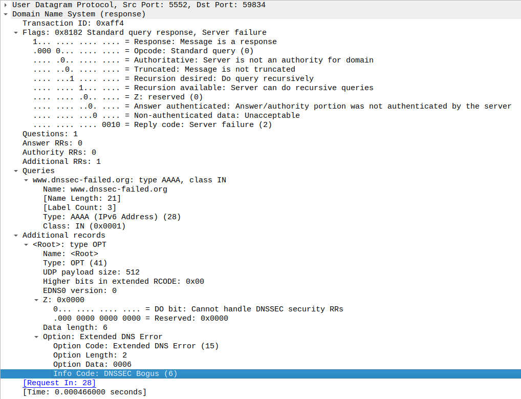

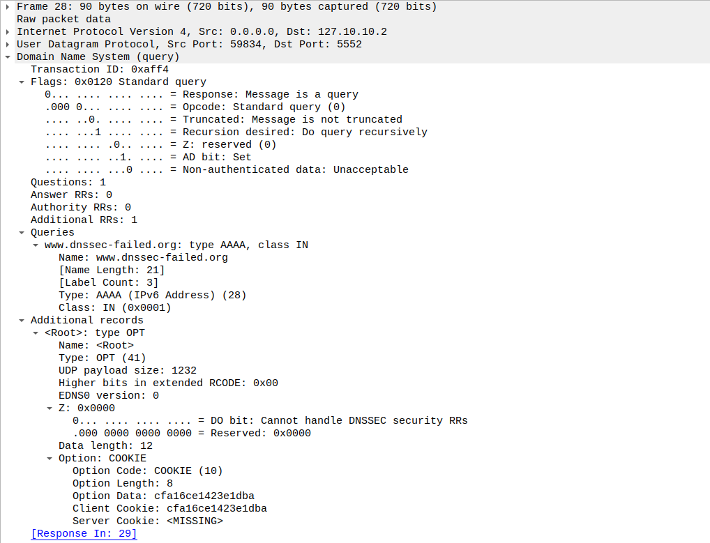

Working
Request (packet 28)
Response (packet 29)

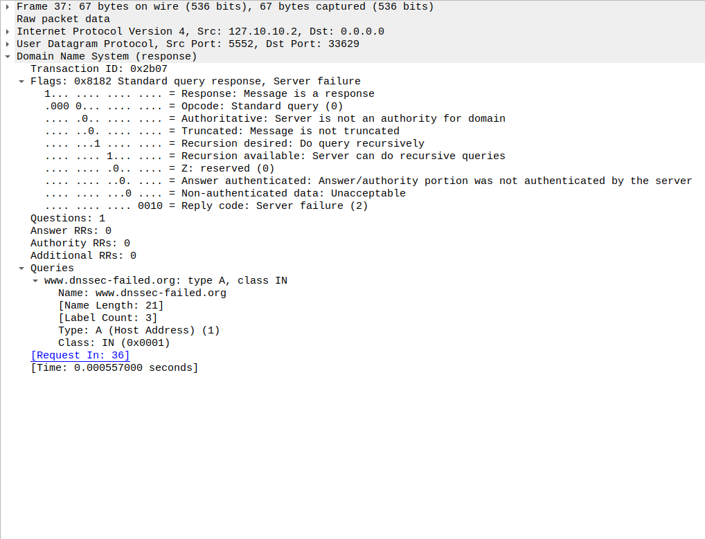

Not working
Request (packet 36)
Response (packet 37)

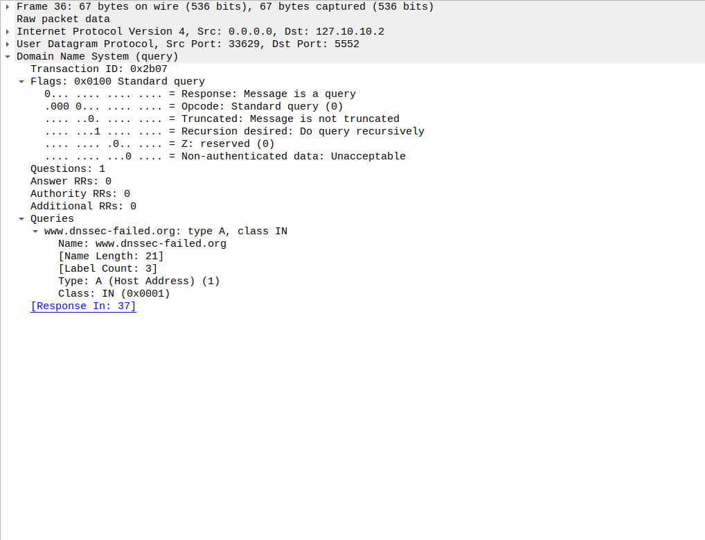

You may have noticed that the "working" request looks different (much longer, less white area) than the "not working" one. dig is telling dnsmasq (which does nothing more than forwarding the request to unbound) that it explicitly that it supports EDNS data. The browser lookup doesn't do this (missing "EDNS0 version: 0" in the "not working request" Wireshark screenshot above) and, as consequence, unbound doesn't attach the EDE at all. One may now argue whether this is expected (and intended) behavior or not but I could understand if the unbound folks say that they don't want to provide information that has not been requested (or, rather, where support for has not been announced).
Now that we know what is happening, we can reliably trigger it with
dig +noedns www.dnssec-failed.org

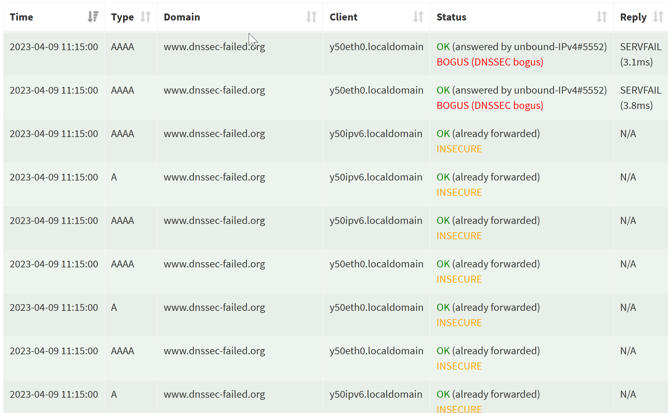

improvement, but still some confusion (screenshot is all from edge, not in pcap)
FTL.zip (16.4 KB)
latest results, the number of wrong entries has decreased - very few wrong entries, sometimes none (cache?)
FTL.zip (38.5 KB)
your latest commit failed to build?
The log only shows 11:11:00 - 11:11:43 so 11:15:00 from your screenshot is not included.
However, looking at the screenshot alone suggests that this is happening because so many queries are needlessly done in parallel. dnsmasq identifies them as being exact duplicates and simply ignores them altogether ("already forwarded"). 50 identical queries will receive only one reply in the end. You see hte INSECURE here because of a glitch in the new FTL logic that says "if it is neither SECURE not BOGUS, then it must by INSECURE". In the exact case you have found, this is not true because they are ignored so their DNSSEC status is actually none at all. I'm working on this as time allows, the failed build is actually right, I forgot to adjust the tests in case of failed duplicated replies.
already forwarded -> unknown status ?
means no info displayed in the query log ?
Yes, because they are ignored. Looking at your screenshot
all of the "already forwarded" are thrown away and not forwarded another time to unbound to (a) not overwhelm it and (b) because it is not necessary, dnsmasq knows it is already in progress. They are also never answered (hence reply N/A) so there is really nothing to see here. Already pushed - tests should pass now passed, binaries ready.
