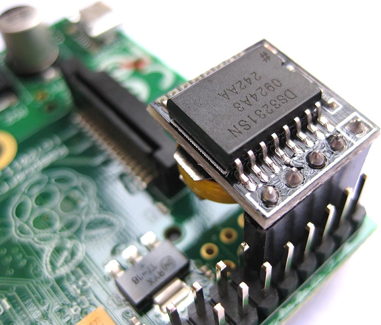

Pi's do not have an onboard clock and rely on external time servers to keep their time accurate. When you shutdown your Pi or have a power outage, this is causing the problem.
If you put the Pi on a UPS (to protect against power outages) and don't shut it down, you won't have this time problem.
You can also buy an add-on clock for a Pi that has a small battery. This is one example:

  • buy and install a real time clock
