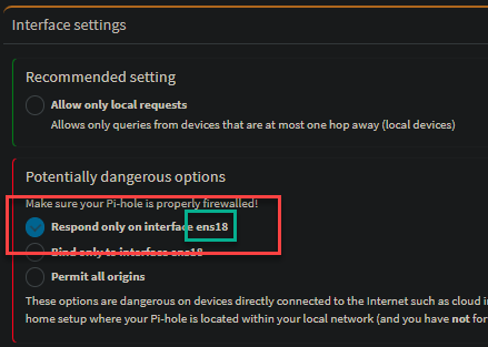

On my existing PiHole v5 instance (Proxmox VM), i've configured Settings > DNS > Interface Settings to use the Respond only on interface ens18, instead of the Recommended Setting of Allow only local requests option.
This works fine in my instance.

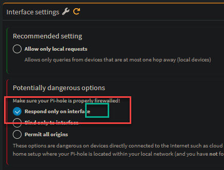

I've spun up another VM for PiHole v6 and configured the same options but after doing so, I get a DNSMASQ_WARN interface eth0 does not currently exist warning.

It seems the GUI no longer displays the interface that Pi-Hole uses :
v5
v6
Is by design, an oversight or a bug in application's rewrite?

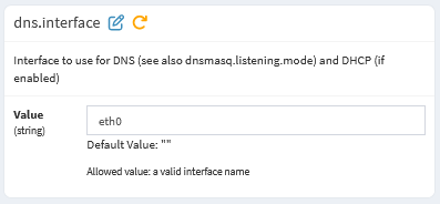

Find Settings | All settings » DNS and set dns.interface to ens18.

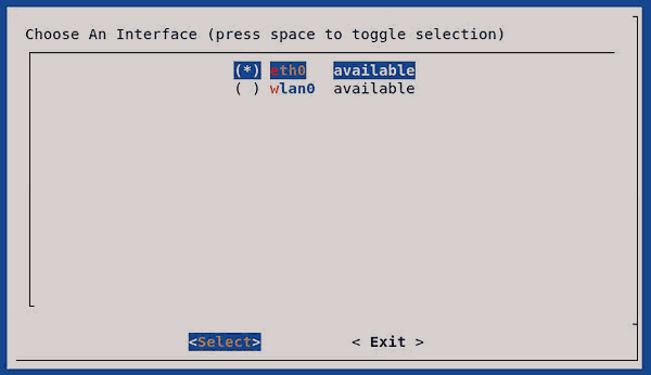

Then you've only ever installed it on systems with only one active network interface.
Choosing a network interface is the first dialog to appear after the welcome screen:

@rdwebdesign, the current v6 Interface settings lacks an interface name.
In absence of an interface, would switching to Respond/Bind only on interface default to eth0?
I don't know.
I didn't work in the v6 installer changes. Maybe @PromoFaux and @yubiuser can answer your question.
The web interface was missing the interface name, but that was just a cosmetic issue.

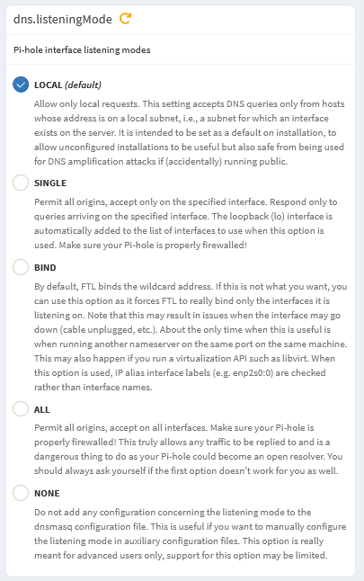

The settings on the image above never change the interface. This options change only the dns.listeningMode:
To change the interface, you need to use the "All settings" page and change dns.interface:

As instructed, I set the Setting | All Settings | DNS | dns.interface to ens18, and the DNSMASQ notification has cleared.
