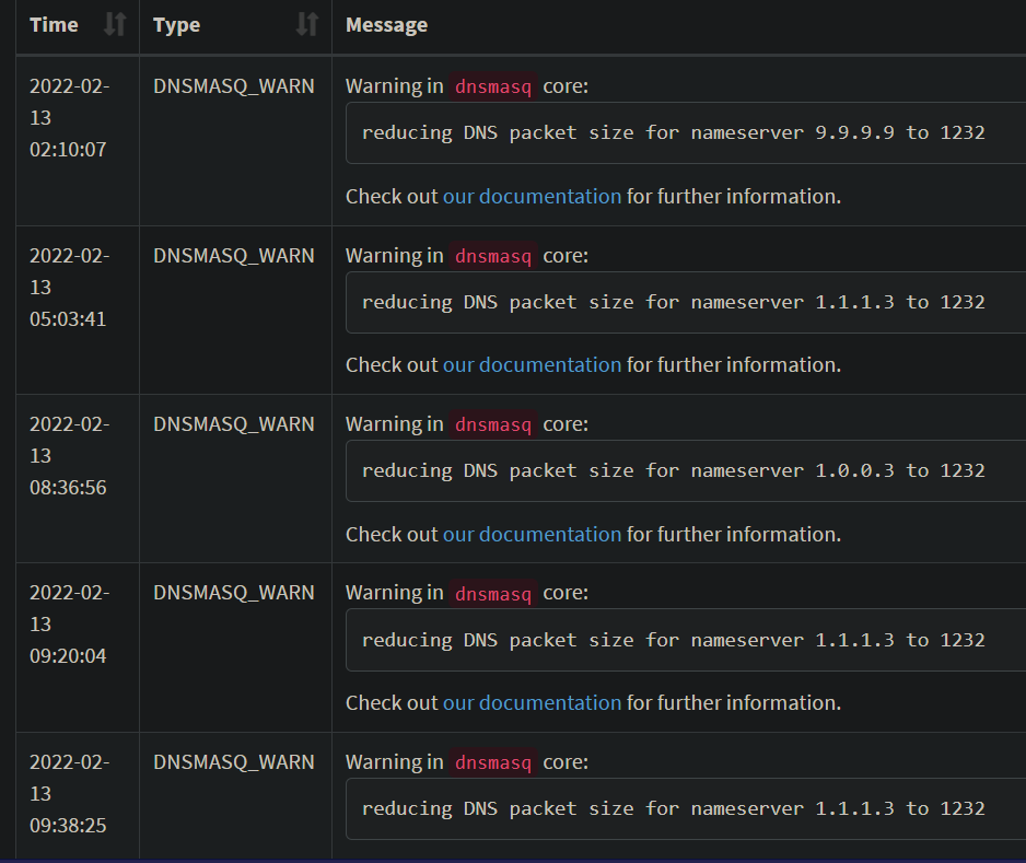

OP here, was there a change pushed? because I just got the following errors, even though I changed the file that should fix the issue.
Maybe it's a coincidence and your upstream reduced just now to 1232. As you reduced to 1280 it's still larger than 1232.
So what has changed? Was this changed on their end?
I just tried it and can confirm (at least for 9.9.9.9) that they changed it to 1232. I have no idea why you got it also for the other two, while I see
1.1.1.3 -> 1452
1.0.0.3 -> 1452
9.9.9.9 -> 1232
Maybe you should just change the config to
edns-packet-max=1232
the cloudflare manual mentions this/
we end up with a maximum DNS message size of 1472 bytes for IPv4 and 1232 bytes in order for a message to fit within a single packet. If the message is any larger than that, it will have to be fragmented into more packets.
source: DNS Flag Day 2020
not sure if this has something to do with the probe and the actual size, but I still get the error if I don't bring it down to 1232. so maybe fragmentation is not supported?
not sure is this also affects other dns servers this way.
also I'm not sure why dns packages should be any larger then this.
