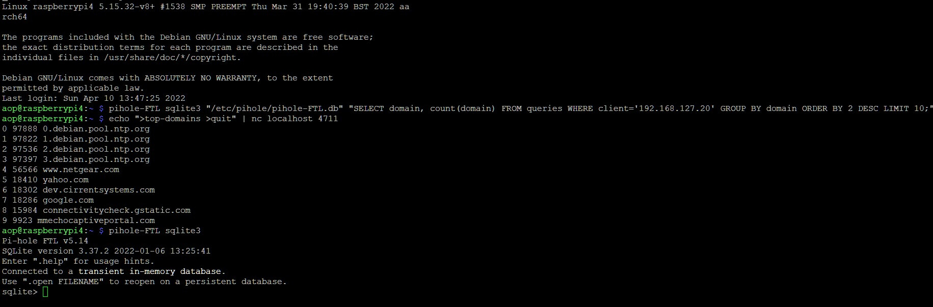

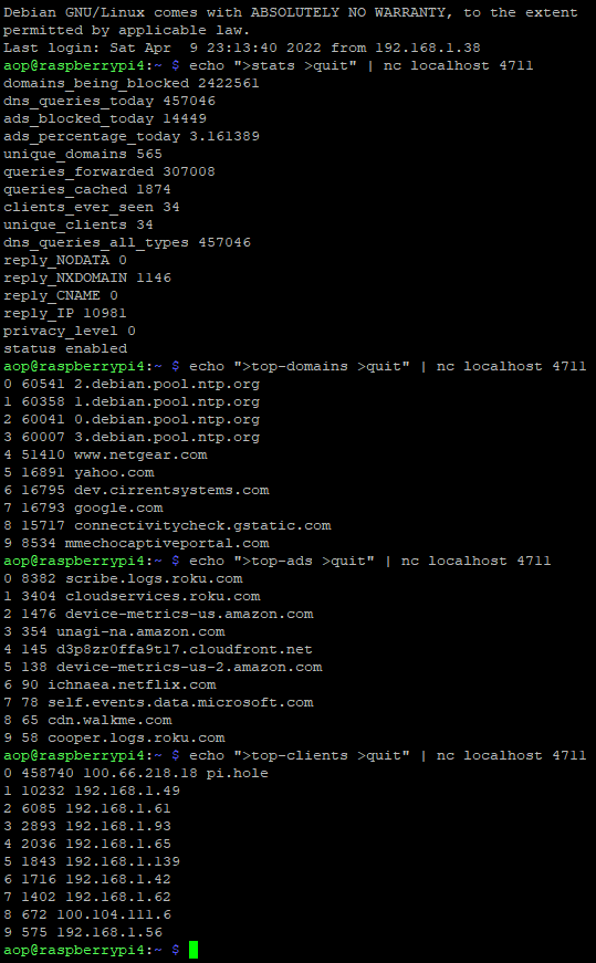

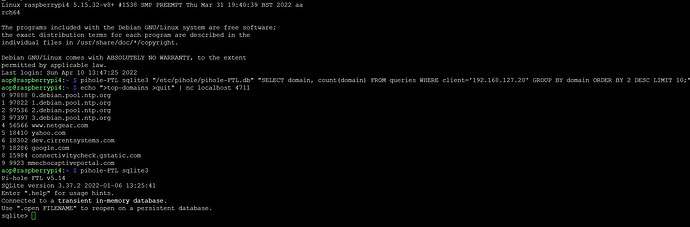

Run from your Pi-hole host, what do the following commands return:
echo ">top-domains >quit" | nc localhost 4711
echo ">top-ads >quit" | nc localhost 4711
echo ">top-clients >quit" | nc localhost 4711
I don't understand, I've been using .129 as the redundant Pi-hole on a Zero2, with 1.1.1.2, 1.0.0.2 as the upstream DNS, without issue on the Ubiquiti EdgeRouter-X.
So you're telling me I can only have one Pi-hole server as the DNS service without a backup?
Also this is what I can in the output of the commands in the image below
Here's the newest token log: https://tricorder.pi-hole.net/wkAN8gGa/

Your results show that you've got two public IPs among your top clients (starting with 100).
The top one seems to be related to a tailscale0 interface of your host -something VPN related?
*** [ DIAGNOSING ]: Network interfaces and addresses
   4: tailscale0: <POINTOPOINT,MULTICAST,NOARP,UP,LOWER_UP> mtu 1280 qdisc pfifo_fast state UNKNOWN group default qlen 500
       link/none
       inet 100.66.218.18/32 scope global tailscale0

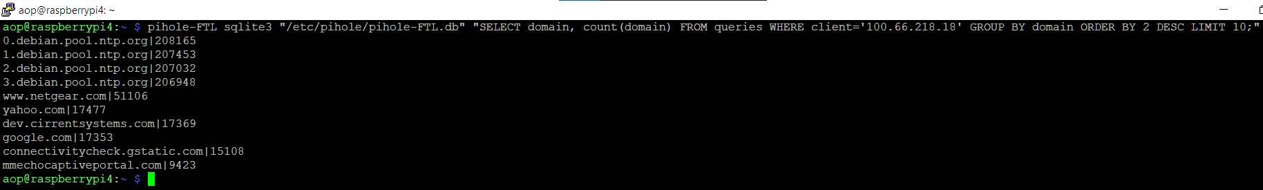

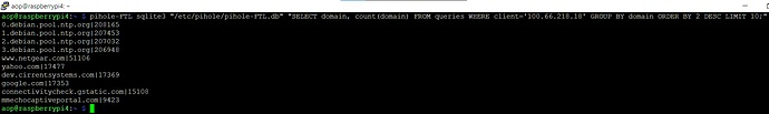

That client IP has issued about 458,000 requests - by far the most requests, dwarfing the next in line by a factor of roughly 45.
Let's check what domains are requested by that client most often.
Please share the output of:
pihole-FTL sqlite3 "/etc/pihole/pihole-FTL.db" "SELECT domain, count(domain) FROM queries WHERE client='100.66.218.18' GROUP BY domain ORDER BY 2 DESC LIMIT 10;"
I use the Pihole as the DNS resolver for my Tailscale network devices, which is a VPN using WireGuard, when I travel outside of my network.
I copied pasted what you asked and I didn't get an output unless I have to write in the domain and client IP in.
I'm not sure how this command works. But I am still able to access the admin page and the SSH.
My bad - you should run that command for your tailscale0 client IP address 100.66.218.18. I've edited my previous post accordingly.
So you are running Tailscale on your machine hosting Pi-hole as well as on some network clients, and clients are
The vast majority of DNS activity (over 90%) on your Pi-hole at 192.168.1.186 is caused by that client IP of your tailscale0 interface, which matches your observation of those max concurrent warnings appearing since you introduced Tailscale:

Here is the output it gave

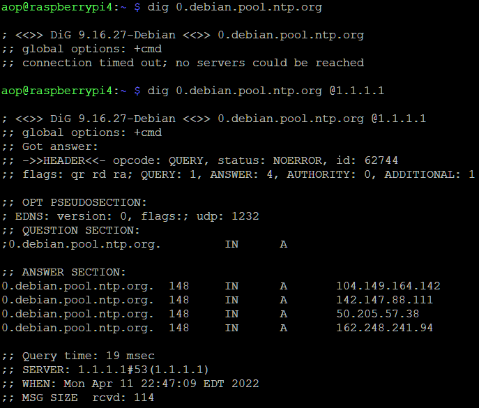

DNS traffic from your Tailscale IP 100.66.218.18 seems desperate to get the IP of a time server. Correct time information is crucial for many cryptographic procedures, so may be as well for your Tailscale VPN service.
Your debug log shows a process tailscaled running, which I assume is your Tailscale VPN software.
Note that DNS resolution on Pi-hole's host system is completely independent from Pi-hole's DNS operation:
While Pi-hole is accepting incoming DNS requests from your clients and forwarding allowed requests to its configured upstream DNS servers, its host system will continue to use whatever it is configured for.
Your debug log shows your host system to point to 1.1.1.1 for DNS resolution:
*** [ DIAGNOSING ]: contents of /etc
-rw-r--r-- 1 root root 45 Apr 11 11:45 /etc/resolv.conf
   nameserver 1.1.1.1
Thus, it is not yet clear why your tailscaled service would use Pi-hole for DNS at all.
Moreover, it is strange that dig 0.debian.pool.ntp.org failed because no servers could be reached, while a dig directed at @1.1.1.1 would resolve correctly, when both of those digs should have been handled by 1.1.1.1.
Please run the following commands on your RPi:
dig flurry.com
dig flurry.com @192.168.1.186
dig flurry.com -p 5335 @127.0.0.1
I'd expect to see IP address replies for all of those but the one that goes to your Pi-hole's IP.
