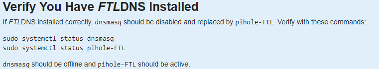

It's not supposed to run, FTLDNS took over the responsibility of dnsmasq (based on your installed version)
ok but after a fresh installation with the installation script no dns service was running.
That was my mistake i think, so i believe that dnsmasq must be running.
