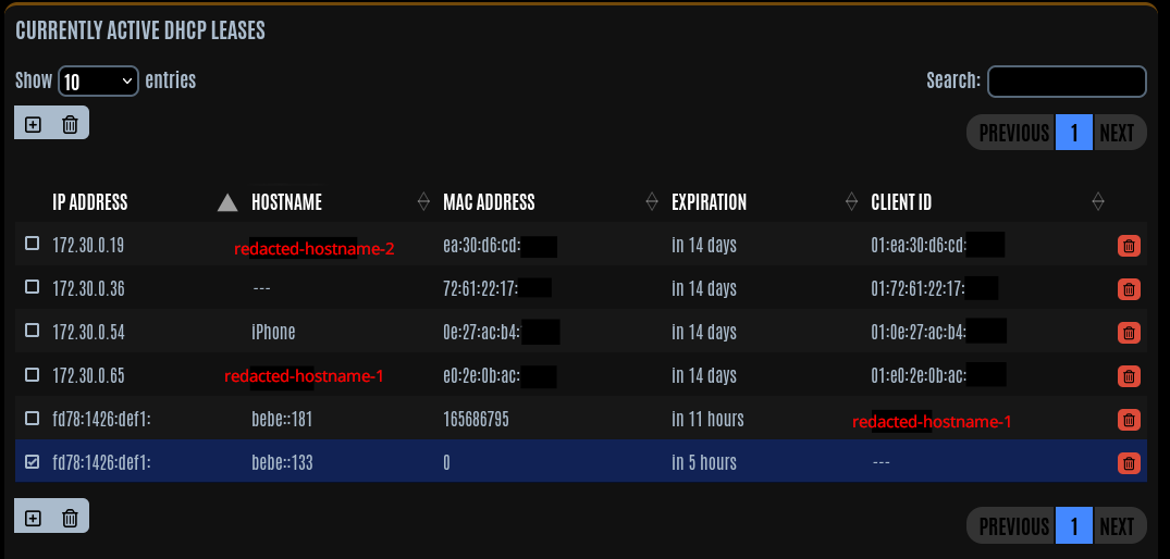

The issue I am facing:
Using custom dnsmasq configuration to provide IPv6 ULA addresses breaks the dhcp leases table in the web interface

The table for active dhcp leases in the web interface looks like this:

The existing code somehow didn't expect IPv6 addresses and, hence, didn't reserve enough space, causing the address to spill over into adjacent fields. Fortunately, the fix is very simple:
@darkexplosiveqwx - are you able to test the fix proposed? sudo pihole checkout ftl fix/api_ipv6
Just came across this discussion via the approval queue on Github, and cannot really speak to the fix as I neither use DHCP, nor IPv6 :slight_smile:
If you could let us know - that would be appreciated!
Thanks for the reminder, I simply forgot to report it as working after I tested it.
My response from GitHub:
The branch fix/api_ipv6 seems to be working, both for viewing and deleting DHCPv6 leases.
