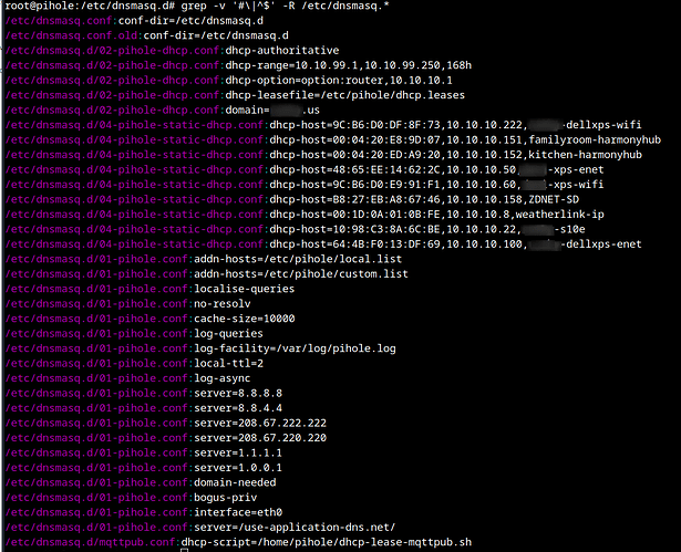

What is the output of the following command - will show all the uncommented lines in your dnsmasq configuration files:
sudo grep -v '#\|^$' -R /etc/dnsmasq.*
Here's a screenshot of the grep output. The "dhcp-lease-mqttpub.sh" script used in the dhcp-script option is shown on the last line:

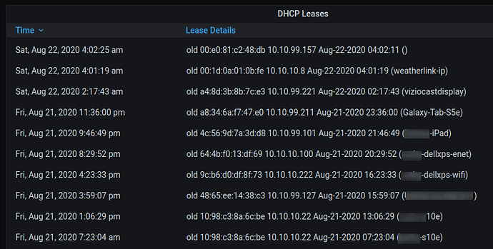

This is the typical output of the script when a dhcp lease is renewed, issued or deleted. This worked until Aug 22, when I did an "apt dist-upgrade" on the PiHole server:
This is likely the source of the problem.
