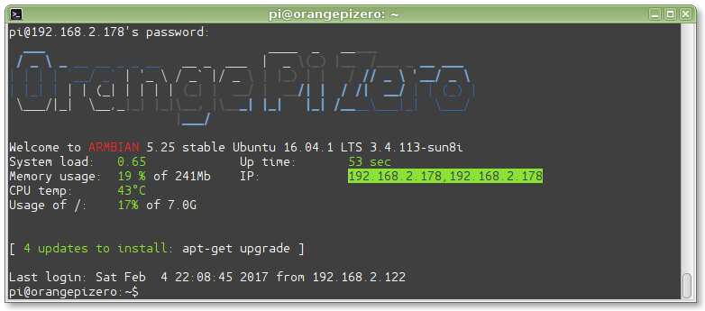

At this point I've decided that one reboot will be nice and once the board was back online and the SSH connection was re-established something very strange was added to my "greeting" header
  ___                               ____  _   _____
 / _ \ _ __ __ _ _ __   __ _  ___  |  _ \(_) |__  /___ _ __ ___
| | | | '__/ _` | '_ \ / _` |/ _ \ | |_) | |   / // _ \ '__/ _ \
| |_| | | | (_| | | | | (_| |  __/ |  __/| |  / /|  __/ | | (_) |
 \___/|_|  \__,_|_| |_|\__, |\___| |_|   |_| /____\___|_|  \___/
                       |___/
Welcome to ARMBIAN 5.25 stable Debian GNU/Linux 8 (jessie) 3.4.113-sun8i
System load:   0.36             Up time:       1 min
Memory usage:  10 % of 494Mb    IP:            192.168.1.3,192.168.1.3
CPU temp:      39°C
Usage of /:    4% of 29G
Last login: Sun Feb  5 01:15:44 2017 from 192.168.1.76

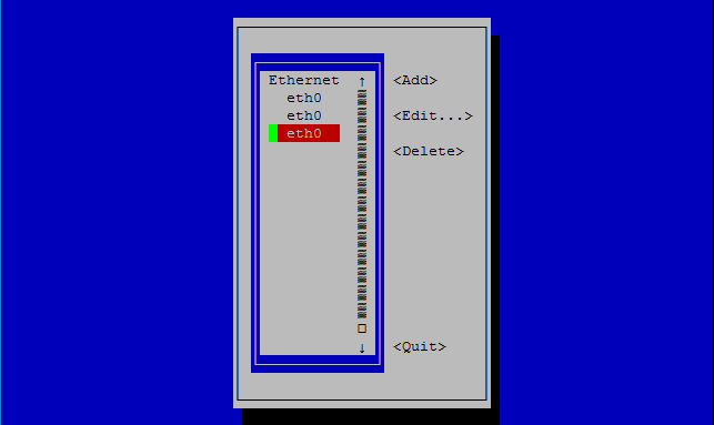

Do you notice the IP address? Quick check with nmtui shows 2 eth0 connections - first one is the manual configuration done by me few minutes earlier (this connection is set to "Auto connect") and the second one almost the same but without DNS records and without "Auto connect" selected....

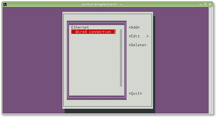

After few more restarts I've noticed that I have 3 eth0 records in nmtui.... Something is very wrong - let's fix it :smiley:
Okay, I now read:

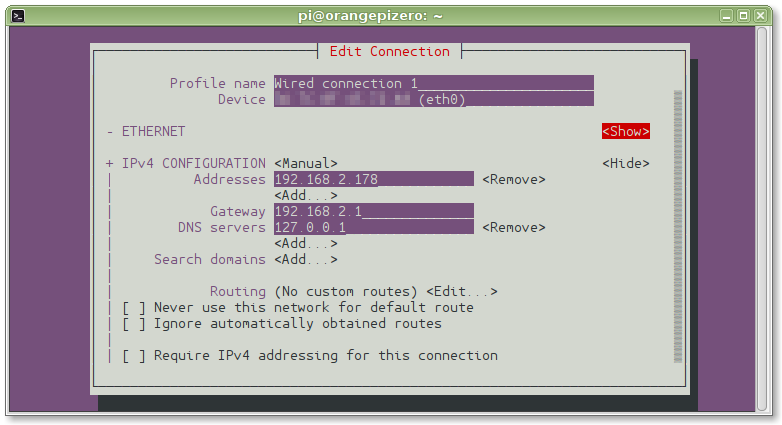

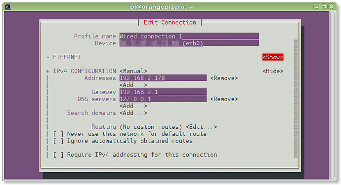

That might be the major difference to my test, since I used the Pi-hole installer for setting a static IP address.

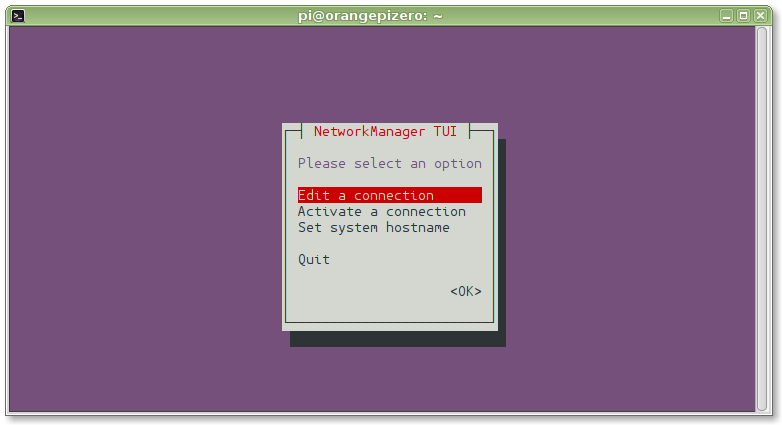

I wiped out the SD card and started afresh - I still use the Ubuntu image, start with no Pi-hole installed and no static address set so far. I did the following now:

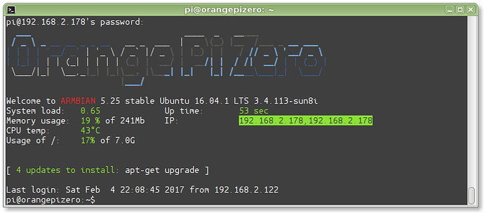

After the reboot, I see the very same problem you were seeing (two IP addresses):
pi@orangepizero:~$ ip -4 a
1: lo: <LOOPBACK,UP,LOWER_UP> mtu 16436 qdisc noqueue state UNKNOWN group default
2: eth0: <BROADCAST,MULTICAST,UP,LOWER_UP> mtu 1500 qdisc pfifo_fast state UNKNOWN group default qlen 1000
    inet 192.168.2.178/32 brd 192.168.2.178 scope global eth0
    inet 192.168.2.178/24 brd 192.168.2.255 scope global eth0

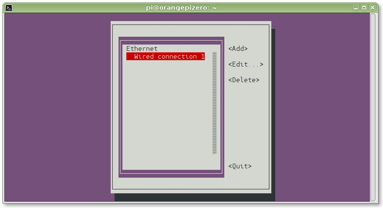

After a second reboot, the double IPs on the welcome screen issue are gone and everything seems functional:
Afterwards, I installed Pi-hole using the installer script. Everything went smooth, so I went for another reboot. lighttpd and dnsmasq started successfully and I was able to use the Pi-hole as usual.
