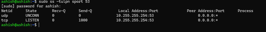

Something on your OS is already using port 53, which is the port that Pi-hole needs for itself. The debug log doesn't show what that something is. Can you copy and paste the output from this command run in a terminal on the Pi-hole please? That should reveal it.
sudo ss -tulpn sport 53

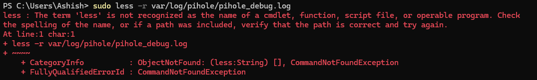

To see it, open a terminal window and enter the command
sudo less -r var/log/pihole/pihole_debug.log
Scroll with cursor keys, page up/down or the mouse wheel typically.
@chrislph
Your above output suggests that you would have deployed your Pi-hole in some kind of virtualised environment running Ubuntu on a Windows machine.
The commands you were given are intended to be run on the OS hosting your Pi-hole, i.e. from inside your Ubuntu virtual machine.
You have run them on Windows, prompting your error messages.
You should consider to consult documentation for your chosen virtualised environment, as it would depend on that virtualised environment how it would allow to access its command line interface.

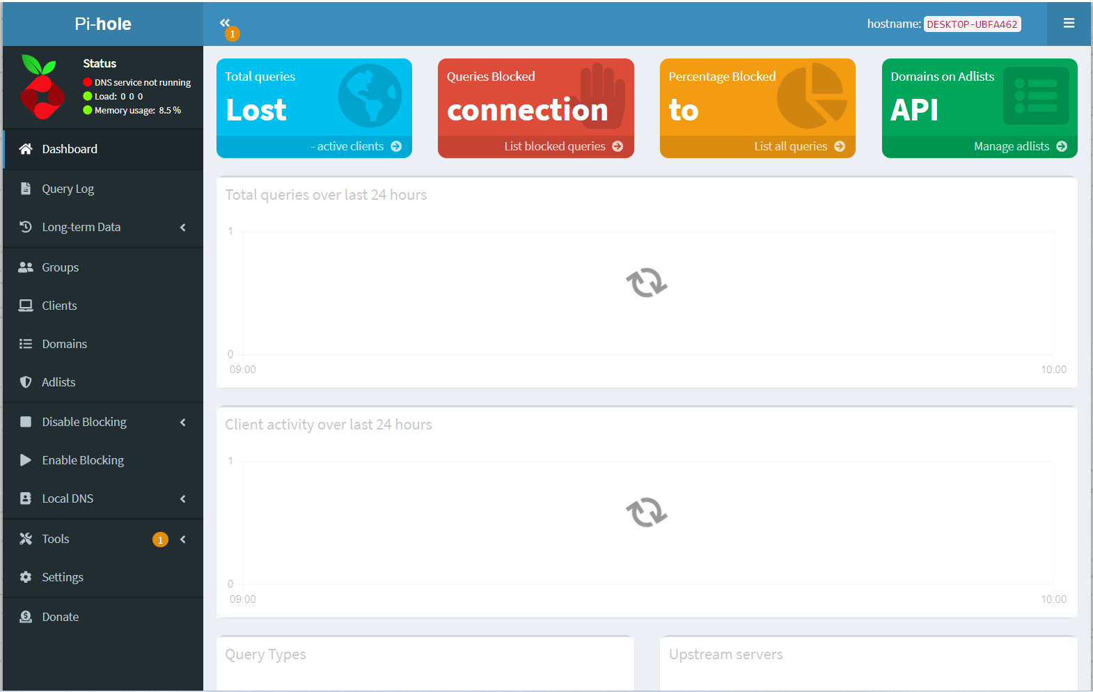

Pi-hole Not running
Debug Token: https://tricorder.pi-hole.net/L5c9PJYr/
@jfb @chrislph Please assist me

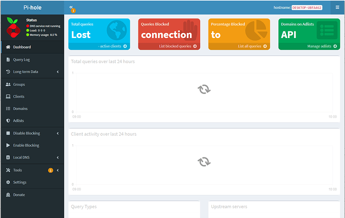

As explained previously, Pi-hole is not working because it needs to use port 53 and something else is using that port. The original debug log didn't reveal what that was, and the ss command I asked you to run also didn't reveal it.
Because FTL is not running, that is why you are seeing the Dashboard "Lost connection" message.
This most recent debuig log shows that port 53 is in use by Unbound, and that is what is stopping FTL from running.

In addition to unbound binding to port 53 as mentioned by chrislph, there is also another unidentified process:
[✗] udp:10.255.255.254:53 is in use by  (https://docs.pi-hole.net/main/prerequisites/#ports)
[✗] tcp:10.255.255.254:53 is in use by  (https://docs.pi-hole.net/main/prerequisites/#ports)
It is likely that this is the DNS service provided by your VM, so this would again seem to be tied to the specific virtualisation environment (which you haven't disclosed yet) that you are using to run an Ubuntu OS inside your Windows.
You should consider to consult documentation for your chosen virtualised environment for details on its internal DNS service, and whether and how it would support disabling it.
