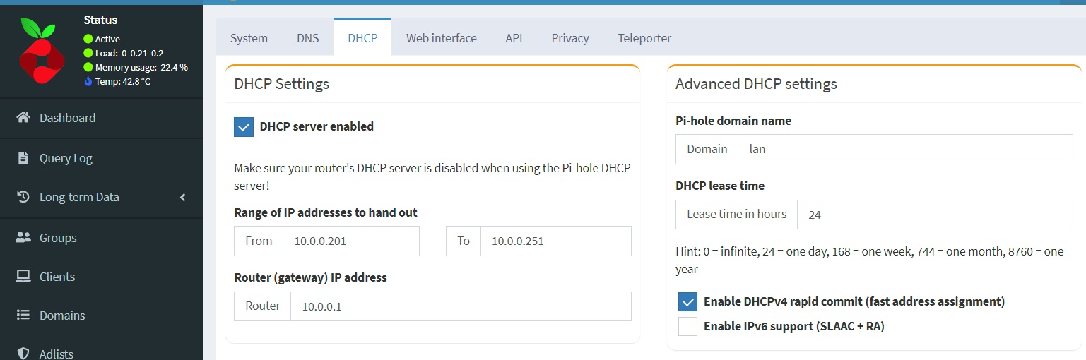

It appears to be added from a DHCP server lease, your DHCP server is advertising the IP address of the Pi-hole DNS server on each interface. How have you configured the IP address on the Pi-hole server's individual interfaces?
   Timeout: 10 seconds
   * Received 300 bytes from wlan0:10.0.0.144
     Offered IP address: 10.0.0.220
     Server IP address: 10.0.0.144
     Relay-agent IP address: N/A
     BOOTP server: (empty)
     BOOTP file: (empty)
     DHCP options:
      Message type: DHCPOFFER (2)
      server-identifier: 10.0.0.144
      lease-time: 86400 ( 1d )
      renewal-time: 43200 ( 12h )
      rebinding-time: 75600 ( 21h )
      netmask: 255.255.255.0
      broadcast: 10.0.0.255
      dns-server: 10.0.0.144
      domain-name: "lan"
      router: 10.0.0.1
      --- end of options ---

Somehow there is a DHCP server leaking from the WAN side:
   Timeout: 10 seconds
     BOOTP file: (empty)
     DHCP options:
      domain-name: "lan"
      router: 10.0.0.1
