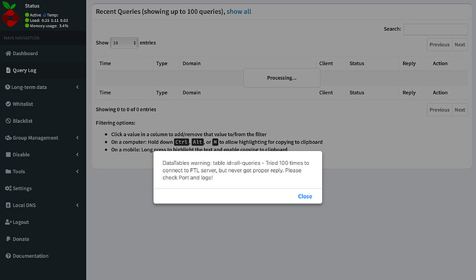

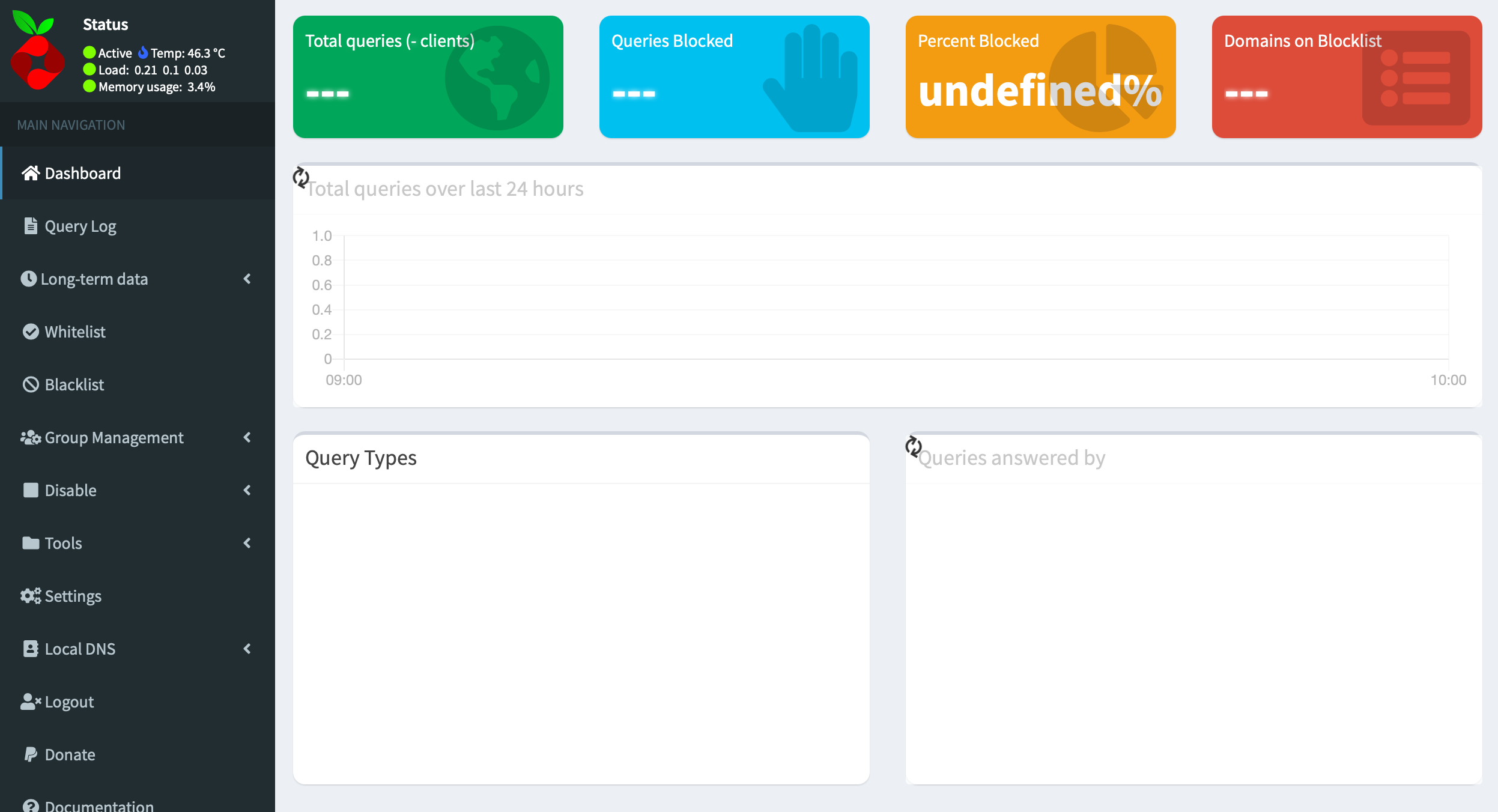

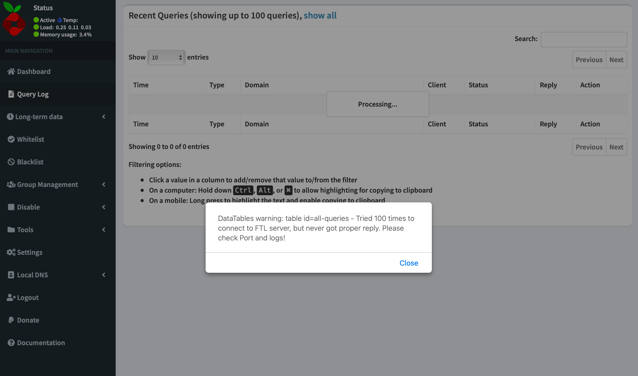

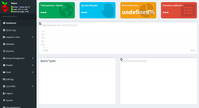

But now, I am getting the symptoms of the Offline FTL and DNS not running error.
DNS and FTL are still running, but I am getting the following errors/symptoms now:
No GUI Log data:
This error appears in Pi-Hole Dashboard > Query Log (It is also common error I believe):
DataTables warning: table id=all-queries - Tried 100 times to connect to FTL server, but never got proper reply. Please check Port and logs!
Pi-hole will create them on startup.
How do you judge this? From the green status indicator?
If this is try, then only your web interface would be broken according to the DataTables warning
