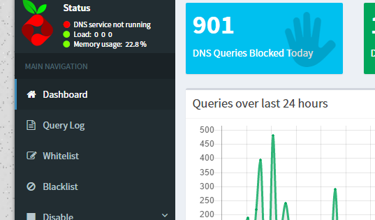

The short story is "DNS service is NOT running". It reports this status on the web interface and via pihole status check. Despite this it seems to still be properly blocking and logging everything I've asked it to. Blacklisted sites are blocked also.

The long version of this story started yesterday when I did an update from ver 2.x.x to 3.0.1. I noticed it was responding sluggishly and for the life of me could NOT get FTL to start or run. After unsuccessfully testing the various fixes for FTL issues I gave up and started fresh. Wiped and created a new VM then did a clean install of 3.0.1. That fixed FTL.
(side note.... FTL isn't working on a different machine I updated from 2.x to 3.0.1 either)
Now this new issue popped up with the DNS service reporting off but actually seems to be on., I do not get an error if I start it manually but is just returns a status of not running if I check it again. If I start it via web page it will go green then go back to not running status if I refresh the page.
Anyone seen this issue pop up? Did the same thing when I tried to set it up on a Debian image also.
-SOLVED-
I looked in the logs after doing a pihole -d and saw an error reference to line 238. Turned out the netstat command was not installed. Installed it any it is showing the DNS service running properly. Now I just gotta figure out the FTL issue on the other box.
