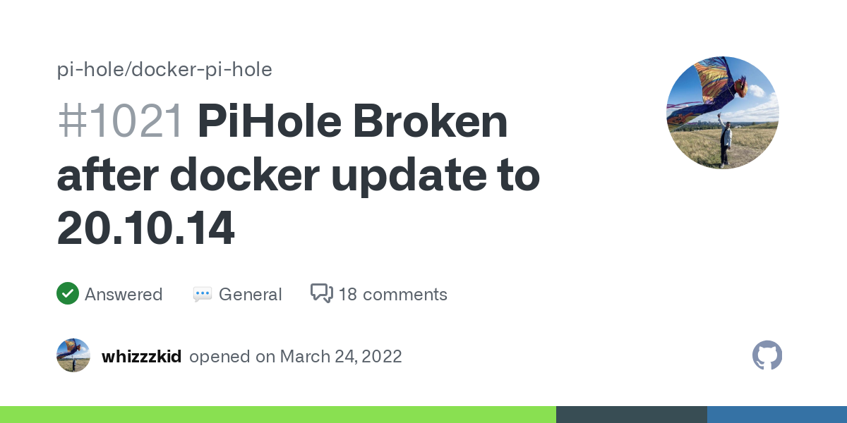

Is this a docker install?
Yes, sorry I added the info in the 1st post.
Okay, first I want to apologize that I did not find this on my own, shame on me. I've set
DNSMASQ_USER: root
and it works again. Thank you so much!
No need to apologize at all! We should have the fixes on the main images today.
