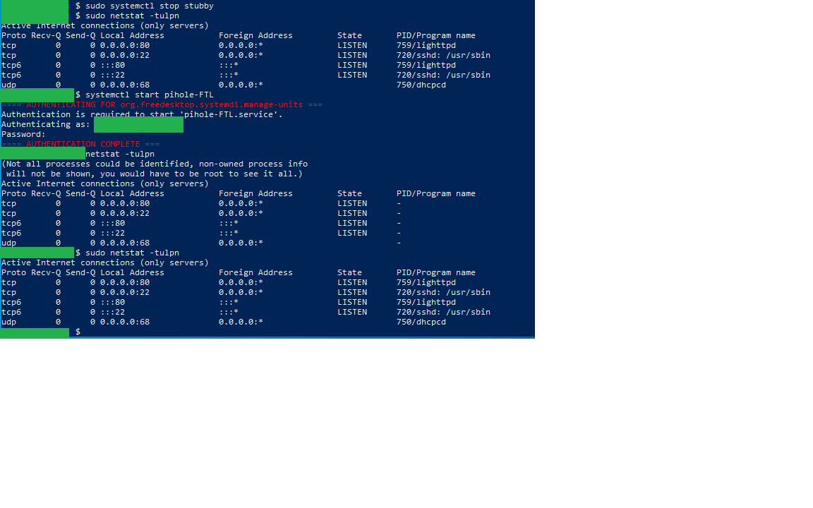

Onto the problem part, with screenshots this time...
You're absolutely right that stubby, as I mentioned above, is using port 53 on 127.1.1.1 What it's not doing is using port 53 on the ip configured on eth0 (192.168.1.217)Which is what pi-hole is configured to use.
I've stopped stubby, tried starting pihole again, and it failed to start (and I forgot to sudo, so I reran with it).
Thanks again!
Danny

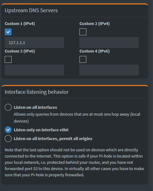

I do have the option set to only use eth0, so I don't understand why pihole-FTL is grabbing everything.

FTL binds the wildcard address, even when it is listening on only some interfaces. It then discards requests that it shouldn't reply to. This has the big advantage of working even when interfaces come and go and change address (this happens way more often then one would think).
The option
bind-interfaces
forces FTL to really bind only the interfaces it is listening on.
Set it in some file like /etc/dnsmasq.d/99-user.conf.
About the only time when this is useful is when running another nameserver on the same machine on the same port. Well, you are looking exactly for this but it is really seldom required (and rarely useful, see the comment about different ports) and given the advantages I described above, it is not the default.
If you're further experimenting here, aso note that FTL automatically adds the loopback interface to the list of interfaces to use when the interface option is used only for some interface. This may be another issue here. Try to circumvent this by setting
except-interface=lo
I haven't been able to try this myself now but wanted to give some ideas for you.
