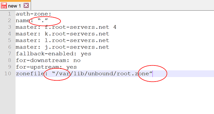

Using unbound 1.8.1
The file is NOT created when starting unbound, no error message. If I manually create an empty file, the file remains empty, again, no error message. In the sample unbound configuration file, the root auth-zone is defined as you describe, but without the zonefile setting.
The only thing I notice is a lot of queries to the root servers, defined in the configuration.
What am I missing?

Good question. I am using 1.8.0 build from sid debian sources and here everything is working fine. (last root zone update 6hrs ago). Maybe some chroot error with unbound? Did you raise verbosity level to check log file?
Found the problem. I copy / paste your example (from discourse) in notepad++. For some reason, the quotes are changed. Changed the quotes, restarted, all OK
Good catch on the punctuation. This happens occasionally on discourse. I edited the referenced post to remove the fancy quotes, but even with that they sometimes re-appear in a copy and paste.
