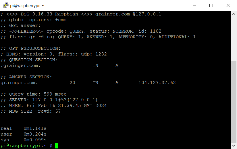

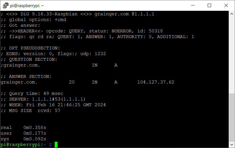

What evidence do you have of slow DNS response?
Slow response navigating to or refreshing web pages somtimes resulting in timeouts.
Updated pihole to latest via command line.
Message generated by pihole after update....
Along the lines of average load over 15mins 1.2 number of processors 1 may result in slow dns response.
This can be due to a number of factors other than slow DNS. There are a lot of steps involved to load an entire web page.
Let's take a look at your DNS process right now.
From the Pi terminal, what is the output of the following command:
time dig grainger.com @127.0.0.1
time dig grainger.com @1.1.1.1

Thanks for the response and insight. Things were running slow and that is what prompted a reboot and update. Things seem better this evening. Output from the query given below:
Nothing to lose sleep over, so unless there is something that comes out of the above, I'll take it that it was just one of those things.
Again thanks for your help.
Forgot to say, like the avatar. My furry family member is asleep along side me.
Comparing the two, the first DNS query (going through Pi-hole) is markedly slower than direct to an upstream DNS server. For comparison, here is the output of the same two commands from one of my Pi-holes running unbound as the upstream DNS server:

They are roughly the same.
This could indicate a configuration or performance problem with your local unbound install, which is what Pi-hole is using for the upstream DNS server.
Shift your upstream DNS server in Pi-hole to something other than unbound and see if the problem resolves.
I took a look at the configuration of Unbound and followed the guidance to disable resolvconf.conf & 'resolvconf_resolvers.conf' as the Pi OS was built on Debian Bullseye.
Repeating the same test gives a significant improvement in the time to resolve the DNS query.
Thanks for your help.
