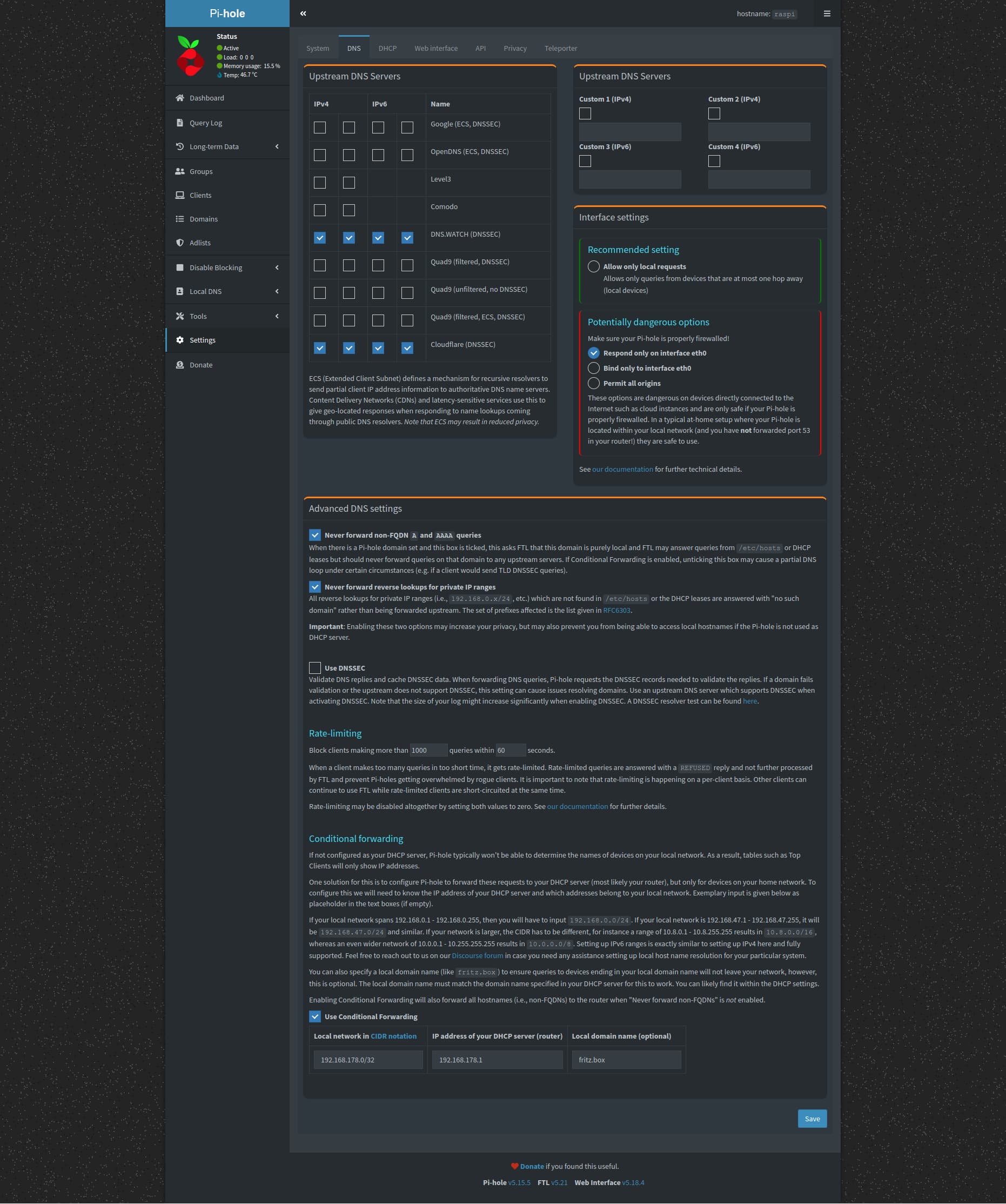

In the router's DNS it's 2a02:810d:b63f:fdc8:72c3:243d:e38:93e0 for the Pihole and in the Pihole there is no custom IPv6 DNS set. Here a screenshot of the config:

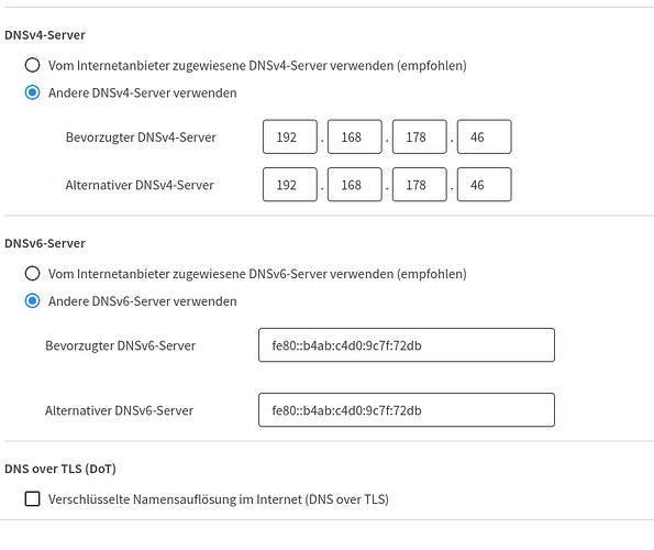

These are the IP's of my router:

You should avoid using a GUA address:
It's not stable, as its prefix is subject to change at the discretion of your ISP.
As the prefix changes, clients wouldn't be able to reach Pi-hole via its deprecated GUA anymore. Dual-stack clients will fall back to IPv4 after a while, which may contribute to your observation.
Use one of your Pi-hole's ULAs or link-locals instead.
You may also want to consider to prevent your router from propagating an IPv6 DNS server address as local DNS server to its clients altogether - provided your router supports it.
The FritzBox line-up should do so, see e.g. Unresolved ipv6 adress in my top list - #4 by Bucking_Horn.

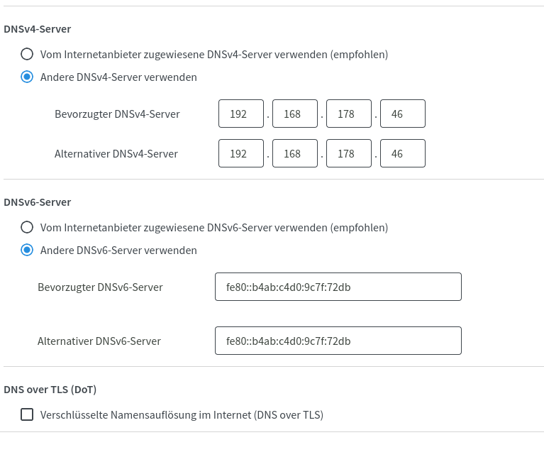

But... when I set now fe80::b4ab:c4d0:9c7f:72db as DNSv6 for internet does it work anyway? I have a dual stack xDSL connection I don't want to use my ISP's DNS.
I only have to options here. Either to use a custom DNS or use the ISP's one.
Yes, as long as your Pi-hole host machine is on the same link as your FB.
In home networks, that's usually the case.
More complex networks with additional routers or L3 switches may split your networks into multiple links/segment, in which case you should use ULAs.

But I see you specified eight (!) upstream DNS servers. As you might know, Pi-hole tries to pick the fastest upstream every now and then. If this choice happens to be a server that replies fast but maybe not to all queries or which doesn't respond every now and then, then this perfectly explains what you are observing: The "fastest" DNS server is re-picked after a restart so the unreliable server is gone until it might eventually be selected again. Reducing the number of upstream servers is very likely to resolve this issue easily.
Not that I know of. But I really had some some of this loops that Bucking_Horn mentioned above in the past. Then I fiddled a bit around and it was gone. Don't know anymore what I've done. :slight_smile:
Hmm, yes. I had also checked Cloudflare as spare DNS. But when you say it's contra-productive I remove Cloudflare and let only DNS.WATCH checked.
