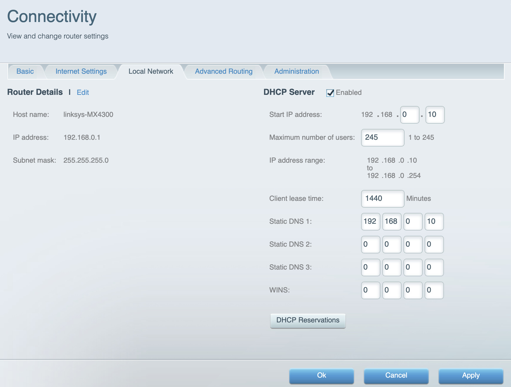

One peculiar thing I noticed is at least on the macbook, the router is returning itself as the DNS server, though I think this is a separate problem since the name lookup failures still occur when I set the DNS server manually on the macbook to the RPi's address
The RPi is 192.168.0.10 and the router is 192.168.0.1.

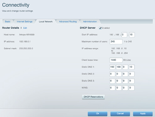

Router Setup

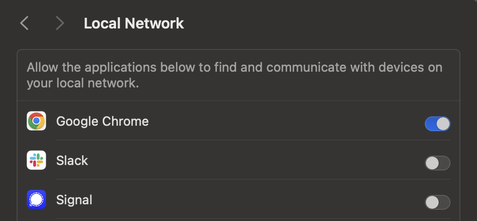

Can you try to disable Local Network in Privacy & security settings on your Mac?
I'm not a MacOS user, but I remember other issues where users had to turn off this option for each browser.
Thanks for your reply. If I'm understanding you right, there's no way to disable "Local Network" in "Privacy and Security" - it's a group rather than an individual setting. What that setting does is allow individual apps to access other addresses on the LAN. For instance, if I disable it for Firefox, I wouldn't be able to access the pi-hole UI at 192.68.0.10:8080. There's no setting for ping/terminal exes
