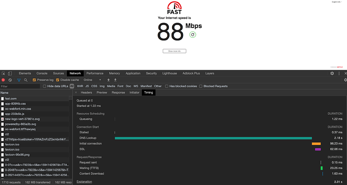

DNS resolution is significantly slower for with IPv4 client address
[Expecting the DNS resolution to happen as fast as the response time taken when pi-hole is not present
-Linux raspberrypi 4.19.57-v7+ #1244 SMP Thu Jul 4 18:45:25 BST 2019 armv7l GNU/Linux]
[ DNS queries are taking ~2 seconds to resolve. Upstream resolver is 1.1.1.1]

Thanks yubiuser, I would do that. But if you observe the time for DNS lookup in chrome network tool, even there it says it's taking around ~2 seconds to finish DNS query.
I'm not sure what chrome network tools does measure as DNS lookup time and if this is reliable.
