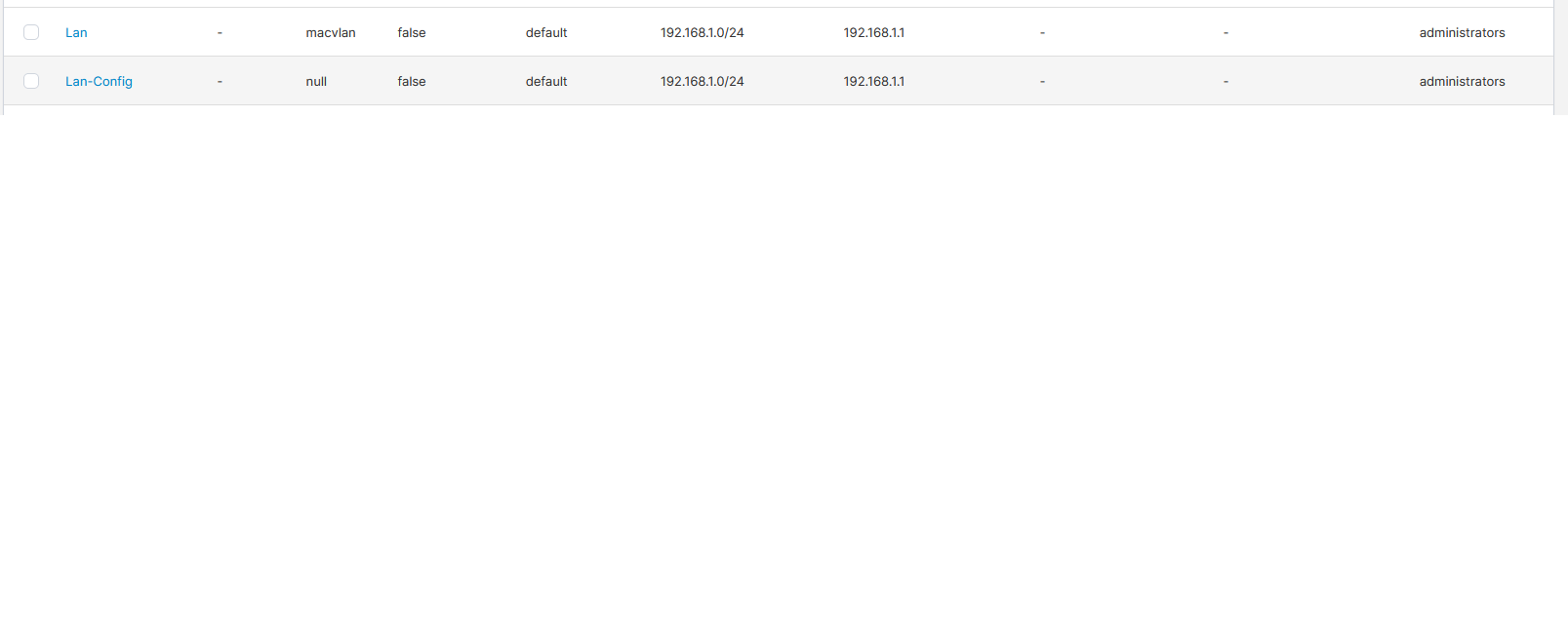

Can it be something related that i have setup the macvlan wrong?
I can still don't get it to work. whit macvlan. When i start the setup in bridge mode it dont have any problem whit dns and running the installation like it should.

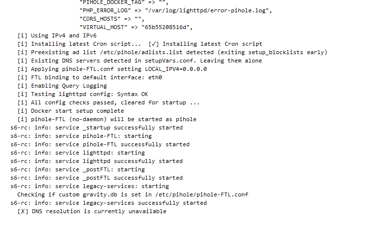

This is the error i getting: [✗] DNS resolution is currently unavailable
What did i do to trigger this: Starting the installation on PiHole
Here is a screenshot from my Portainer log:

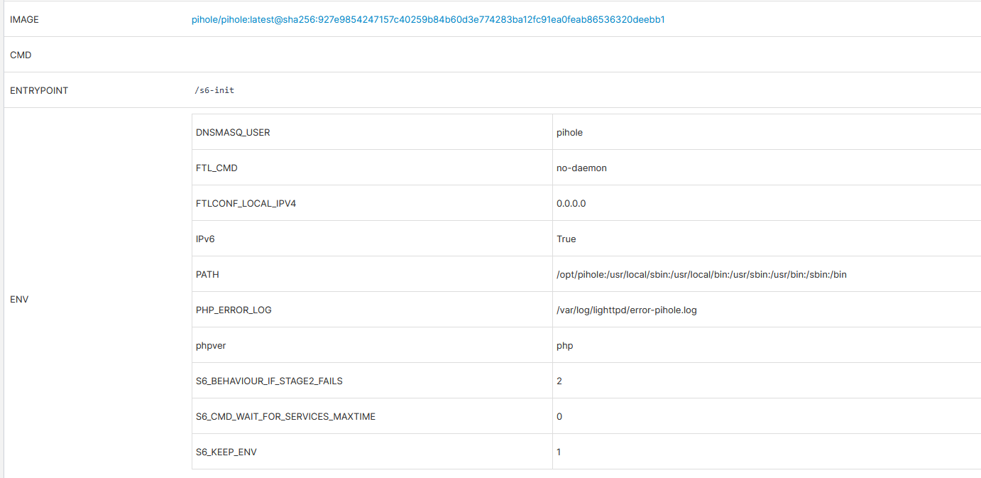

I use portainer and it use the following val container settings
Host/volume Path in container
/portainer/Files/AppData/Config/PiHole /etc/pihole
/portainer/Files/AppData/Config/PiHole/DNS /etc/dnsmasq.d
From my understanding when i have test around it seems like it don't get DNS access when the container is in macvlan network but if i run the container in bridge or host mode it dont seems to get the same problem. Then it seems to be running fine and i am access to the GUI.
