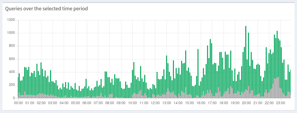

I just checked my router's device list and 78 is accurate, though it's closer to 50 at any given moment as devices go to sleep, etc. That supports four people and several devices running all day. Smart TVs, wifi scales, doorbell, cameras, phones, tablets, e-readers, smart speakers, computers, etc.
Here's the queries from the 24 hour period yesterday. It sort of peaked around 1100, but averages mainly hover around 500-600 on any given day.
I'm running PiHole on a Raspberry Pi Zero W. I agree that it could be the weak link in the chain here, but it did run PiHole 4.x without a hiccup for years.
