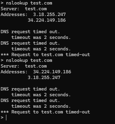

DNS Request Timeout
DNS should be resolving
DNS request is timing out
Additional Info
Been having some odd issues lately. Pi-hole also recently changed the nameserver to an IPV6 address which caused an issue where I could not update gravity, found the solution to that here but not sure what the cause was.
https://tricorder.pi-hole.net/xBykMHPk/
Updated Debug Token:
https://tricorder.pi-hole.net/1wLKkCrk/
Updating in case someone is able to get to this thread in the next 48 hours. Will keep updating, I understand there are lots of help threads to get too.
You're running nslookup interactively:

If do so, you should drop the nslookup part and only enter test.com instead eg:
$ nslookup
> test.com
Server:         10.0.0.2
Address:        10.0.0.2#53
Non-authoritative answer:
Address: 34.224.149.186
Address: 3.18.255.247
Non-interactive you would do below:
$ nslookup test.com
Server:         10.0.0.2
It does seem to produce the correct results if I use non-interactive mode.
I am a bit confused as to why that happens. My understanding was that both modes use the same underlying DNS querying mechanism.
Not sure if you have time to explain it a bit more?
When entering interactive mode like you did in the OP, you entered nslookup on the > prompt.
But nslookup is not a valid interactive command.
Check the man page with below one to check which are (the INTERACTIVE COMMANDS section):
man nslookup
What happened was that you instructed nslookup to lookup the nslookup domainname against DNS server test.com.
Similar as below non-interactively:
$ nslookup nslookup test.com
;; communications error to 3.18.255.247#53: timed out
;; communications error to 34.224.149.186#53: timed out
Or below:
$ dig nslookup @test.com
; <<>> DiG 9.18.24-1-Debian <<>> nslookup @test.com
There is no DNS server listening (ports 53 UDP/TCP) on the resolved IP 3.18.255.247:
$ sudo nmap -sS pi.hole
Starting Nmap 7.93 ( https://nmap.org ) at 2025-01-17 21:23 CET
Nmap scan report for pi.hole (10.0.0.2)
Host is up (0.0052s latency).
rDNS record for 10.0.0.2: ph5a.home.dehakkelaar.nl
Not shown: 997 closed tcp ports (reset)
PORT   STATE SERVICE
22/tcp open  ssh
53/tcp open  domain
80/tcp open  http
MAC Address: B8:27:EB:xx:xx:xx (Raspberry Pi Foundation)
Nmap done: 1 IP address (1 host up) scanned in 0.45 seconds
$ sudo nmap -sS 3.18.255.247
Starting Nmap 7.93 ( https://nmap.org ) at 2025-01-17 21:25 CET
Nmap scan report for ec2-3-18-255-247.us-east-2.compute.amazonaws.com (3.18.255.247)
Host is up (0.11s latency).
All 1000 scanned ports on ec2-3-18-255-247.us-east-2.compute.amazonaws.com (3.18.255.247) are in ignored states.
Not shown: 1000 filtered tcp ports (no-response)
Nmap done: 1 IP address (1 host up) scanned in 11.33 seconds
