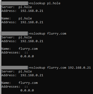

From a client that you'd expect to use Pi-hole for DNS, what's the output of:
nslookup pi.hole
nslookup flurry.com
nslookup flurry.com 192.168.0.26

All of those nslookup results you requested (which I sent from my desktop client) resolve with pi.hole, as shown below:
However, I am still getting ads.
My Pi-hole shows queries on the admin page, so I know it's at least receiving them.

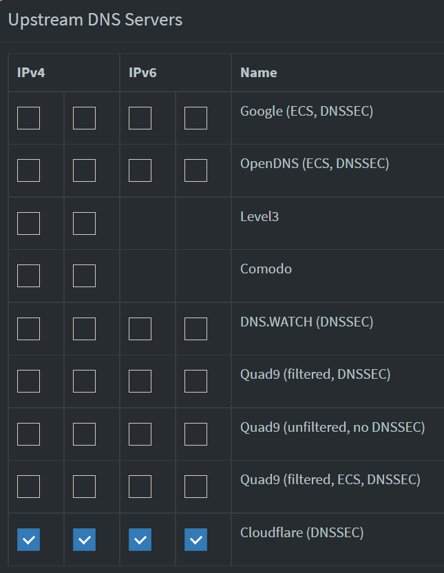

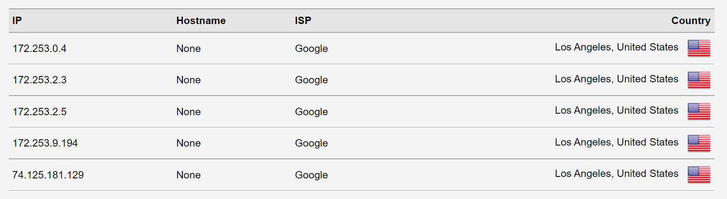

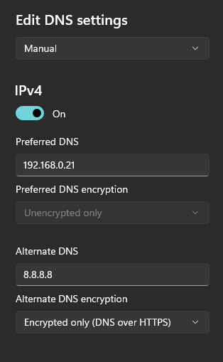

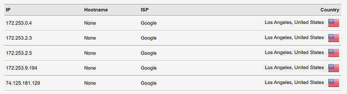

I would also like to add that DNS leak test sites were still showing my ISP for a few results UNTIL I manually went into my network configuration and set it to match the DNS servers I had set on my router, like so:
That seemed to do the trick, however.. the test results show Google and not Cloudflare (which is what I have set as my upstream provider for my Pi), so it's as though the Pi-hole server is still failing to resolve and falling back on Google as shown:

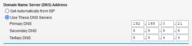

Your router is using Google DNS server.
You added Google's DNS servers as your secondary and tertiary DNS servers.
Your router will use ALL DNS servers at the same time. It will bypass pi-hole, even if pi-hole is online.
All of those nslookupss look fine - they show that your Pi-hole is accessible from your client via its IP, that indeed Pi-hole has been used, at least for those requests, and that Pi-hole is blocking as expected.

Your router screenshot above looks like you could delete the secondary and tertiary servers from your settings and just have the Pi-hole as the primary. Are you able to do that, or does leaving them blank cause them to become auto-populated with Google or Spectrum's servers again? Is that what you mean when you say your ISP forces requests through their servers?
If so, what happens if you put the Pi-hole's IP in there for all three addresses? If it accepts that as valid settings then it might work around the problem and fix things for you.

It does not allow me to leave any severs blank. In order to change them without getting an error I actually had to do something strange where I changed the third one first, then the first, then the second. I looked into it and apparently it's an actual firmware bug with my router that makes setting DNS servers very finnicky.
I was able to put Pi-hole's IP for all 3 and did try that earlier, unfortunately it didn't work. I was still getting DNS leaks that showed my ISP's servers.

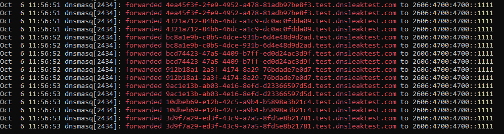

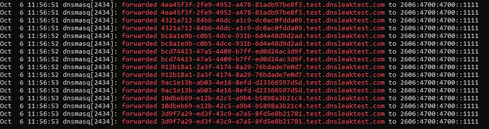

When I use dnsleaktest.com and use the command you posted above, I get this for example:
The IP it's forwarding to is the IPv6 of Cloudflare (my upstream DNS for now), so it's an expected result.. although it seems it is exclusively resolving IPv6, not IPv4.
My ISP's DNS servers do not show up at all, suggesting it's working correctly. In fact no DNS leak sites show my ISP with my current setup, giving the illusion there is no issue.
