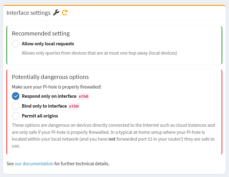

Try to set the Interface as "Respond only on interface eth0" or "Permit all origins".
Settings > DNS page:
If you can't see this option, change from "Basic" to "Expert" mode using the top right button.
Does it fix the issue?
Yes that fixes it. Thank you!
