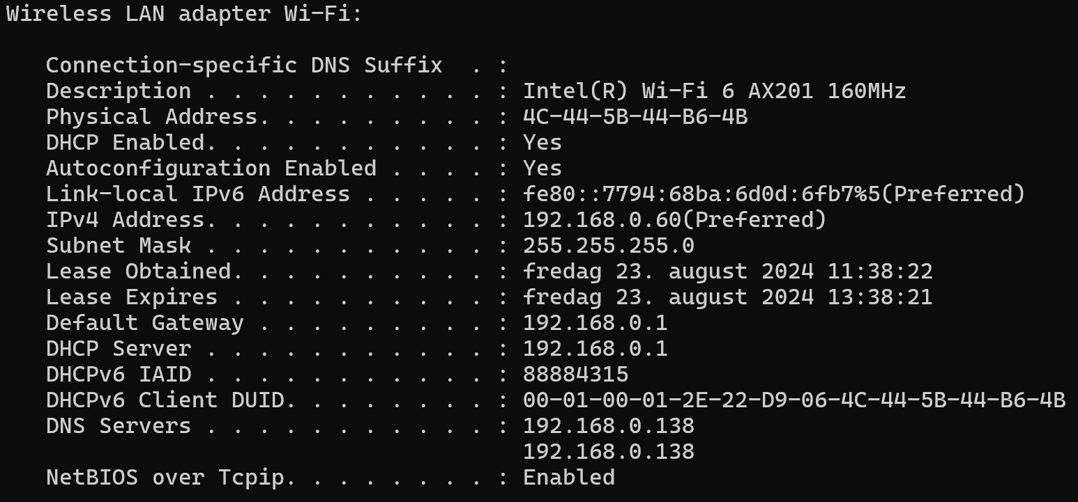

Here is my Windows 11 device ipconfig with the RPI as both DNS servers:

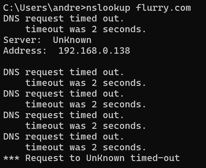

nslookup of flurry.com:

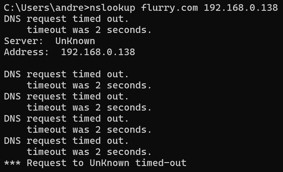

nslookup of flurry.com specified with RPI address:

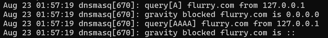

Logs from RPI showing no queries from the Windows 11 device. (it is worth mentioning that these entries in the log are from an earlier nslookup made directly from the RPI, which is working correctly):
